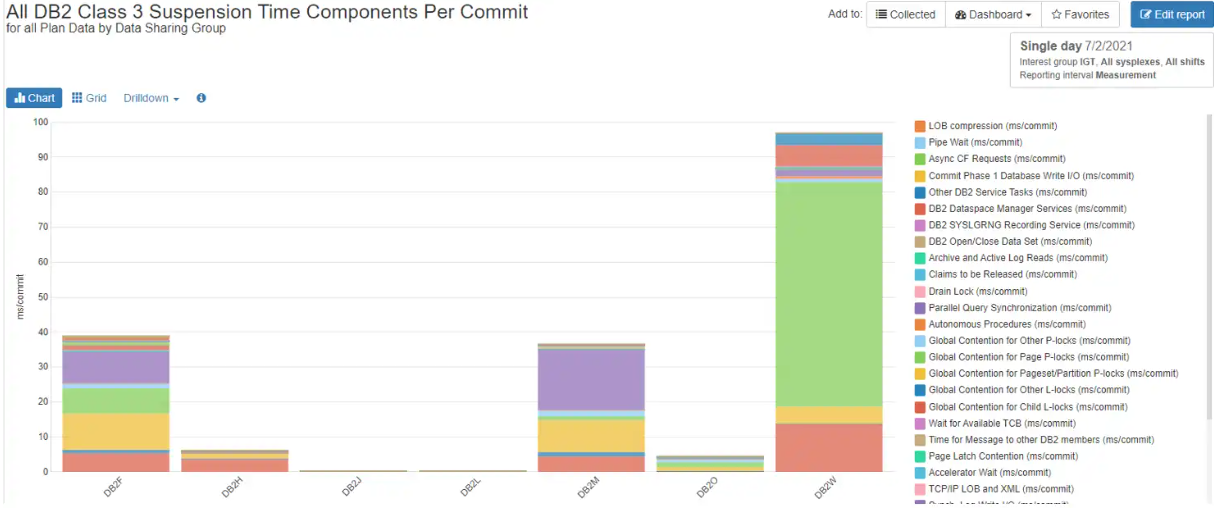

What is most important about wait times? Is it how much suspension time that is attributed to each transaction that executes in your environment?
Figure 1 below shows that there is very little wait time per commit in the DB2H data sharing group. This works for an environment that has transactional applications that get in and out and commit just a few times per transaction. But look at DB2W. There is a great amount of wait time there. If it is a transactional environment, then it is in a lot of trouble.
Figure 1: All Db2 Class 3 Suspension Time Components Per Commit

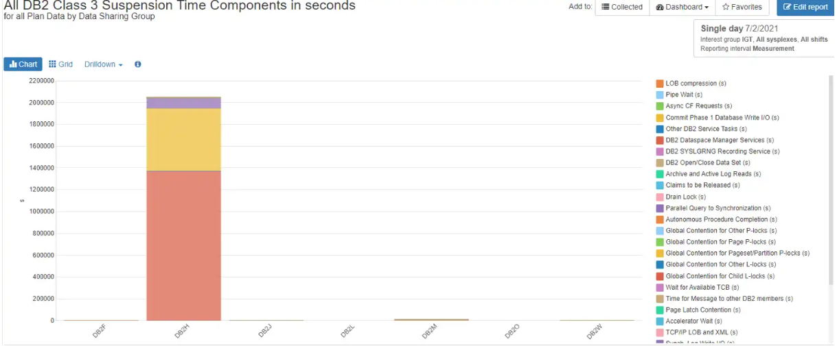

What happens if we look at suspension times as a cumulative value? How many times did our transactions run in DB2H? How much activity was really going on in DB2W? Figure 2 may give us some more perspective.
Figure 2: All Db2 Class 3 Suspension Time Components in Total Seconds
DB2H has now become the standout, and DB2W is practically imperceptible. This implies that there were a great many transactions running in DB2H whose individual wait times added up to a large number. DB2W, in comparison, had a total that is not worth looking at. Looking at suspension times from both directions gives us a view into where our tuning efforts should begin.
Of course, tuning a transaction with a very small amount of wait time that runs millions of times is much more difficult than tuning a batch program that runs only once. But if it is possible, it could save a lot of system resources.

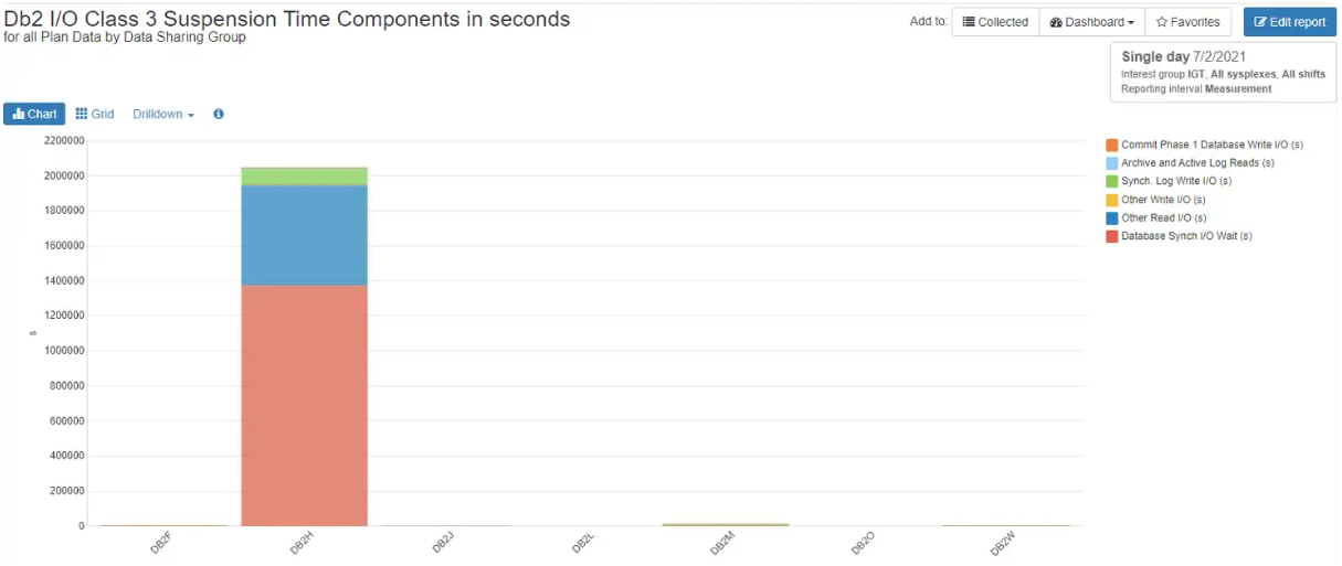

I/O Wait involves write and read operations for databases as well as logs. In our example, DB2H, we see that the highest amount of wait time is attributed to Database Sync I/O. Figure 3 below breaks out all of the I/O wait time.
Figure 3: Db2 I/O Class 3 Suspension Time Components in Total Seconds
Other categories for I/O wait include Commit Phase 1 Database Write I/O, Archive and Active Log Reads, Sync Log Writes, and Other Read and Write I/Os.
To improve database I/O wait time, inspect buffer pool performance.

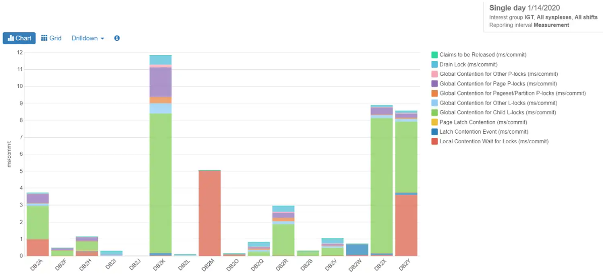

Lock Wait Times
In order to ensure data concurrency and data consistency, Db2 takes locks and latches on objects, and of course these locks and latches can contend with each other and cause wait times. In data sharing environments there is even more complexity as many locks must be propagated to the coupling facility so as to be communicated to other group members.
The chart below shows our DB2H data sharing group as having fairly low suspension times for locks per commit, with the largest portion attributable to global contention in the coupling facility for child l-locks.
Figure 4: Lock Waits ms/commit

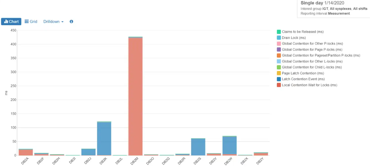

Changing the measurements from ms/commit to total ms, as we did with total suspensions above, we can see in Figure 5, however, that the relative total suspension time for the day is negligible. so obviously waiting for locks is not an issue for this data sharing group. The same is true for our DB2W group.
Figure 5: Lock Waits in Total ms
What happened in DB2M? We can’t know for sure until more research can be done on the type of workload being run there. The waits are mostly for local locks, so it is probable that data sharing is involved very little. Looking into what applications were running concurrently might give us an idea of why these lock contentions are occurring.
