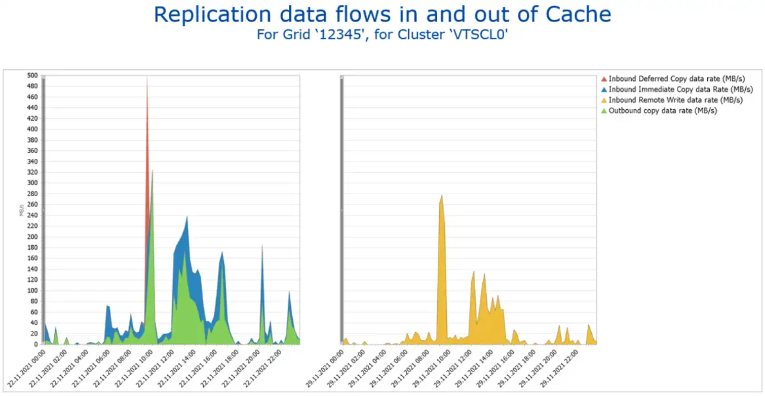

Immediate and Deferred copies read the data from cache to produce the copy. This is shown as “Outbound copy data rate” in the IBM Z IntelliMagic Vision for z/OS chart below. Synchronous Mode Copy does not need this additional read from cache because the write is directly sent to the secondary cluster during the original write. So, one type of reading from cache is not needed anymore using Synchronous Mode Copy.
Figure 1 below compares the cache flow from a cluster before (left side) and after (right side) a customer’s site switched from Immediate and Deferred Copies to Sync Mode.
Figure 1 - Replication data flows in and out of Cache
The workload at these two days was similar. As you can see, the Synchronous Mode Copy is reported as “Inbound Remote Write data rate” and is lower than the MB/s cache flow which was needed for Immediate and Deferred Copies in the week before.
