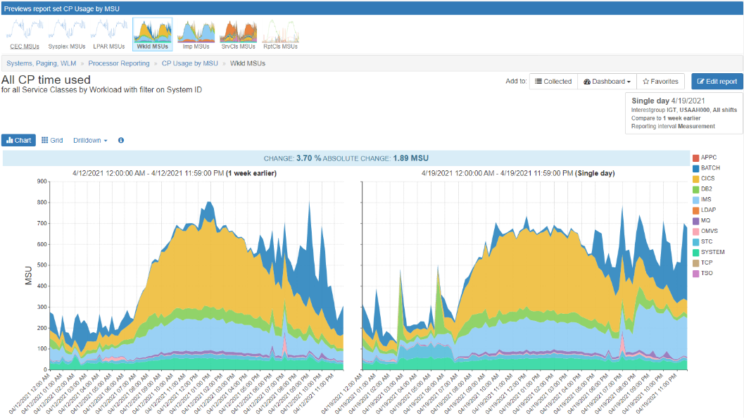

They say a picture is worth a thousand words. Figure 1 shows MSU consumption by Workload, for the same system, for two different days. Do you see anything different?
Figure 1: 24-hour Workload comparison for system SYSA_LI
There are several differences in the chart on the right. In particular, the STC workload increased for several hours in the morning, and the IMS workload increased late in the day. Notice that you didn’t have to take much time, or think a lot, or crunch any numbers to get the big picture quickly.
Humans are a visual species, and we’re pretty good at pattern recognition. You’re probably already thinking things like:
  • The STC increase is about 50 MSUs – not huge, but worth looking into…
  • STC went back down, so they probably already took some action – we just want to make sure it stays fixed…
  • The IMS increase is bigger, and hasn’t dropped yet – better check on that one first…
  • Everything else looks pretty much the same – probably no other follow up needed on SYSA…
  • Is this my 2nd cup of coffee or my 3rd…?
Now that we’ve completed SYSA’s triage-at-a-glance, let’s investigate the IMS workload increase to see what’s going on.

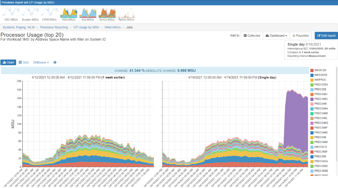

Drilling down to the region level, we see a clear picture in Figure 2.
Figure 2: IMS address spaces
One region stands out with a dramatic increase beginning at 8:00pm.

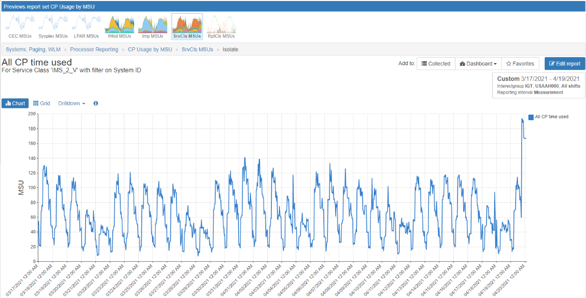

It’s easy to see that this is not typical by reviewing a longer timeframe. Figure 3 shows the service class utilization for these regions for the prior month. Notice the spike on 4/19 - clearly this is not typical.
Figure 3: Prior month view confirms outlier
You can perform further due diligence, reviewing prior months’ data as well as plotting transaction rates vs. CPU consumption. Once you’re satisfied this increase is not business-as-usual, it’s time to ask the IMS team to investigate.

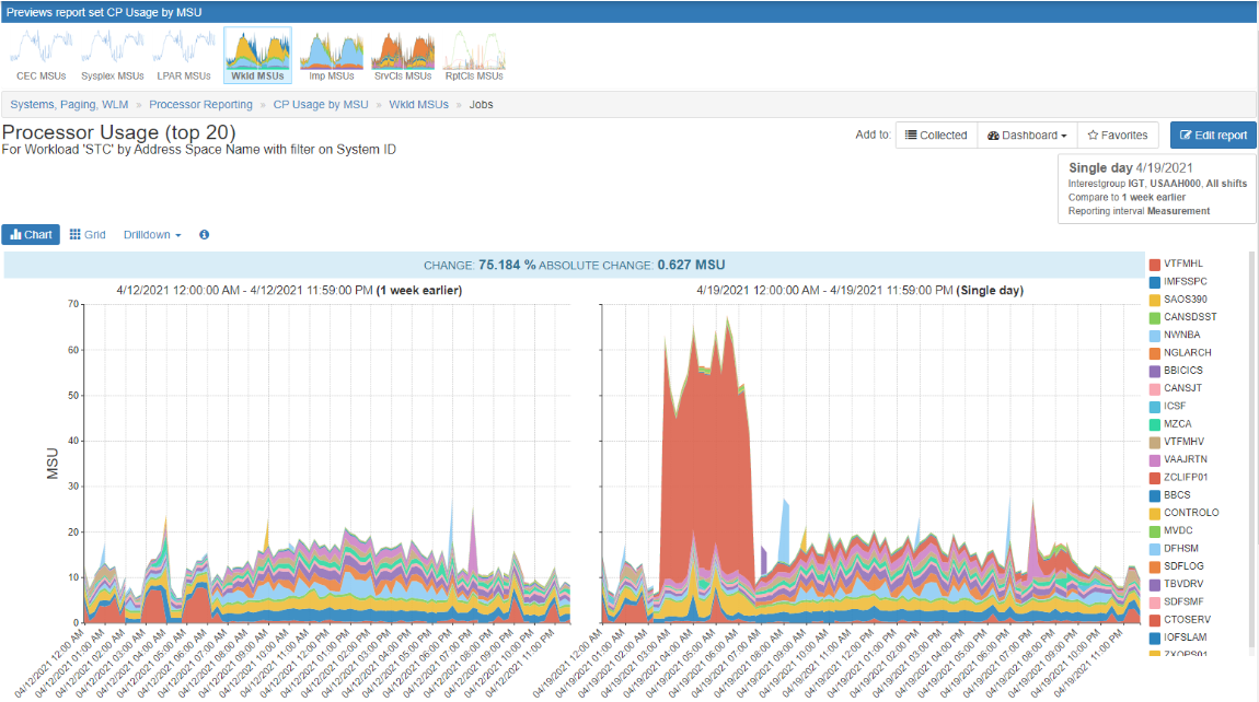

Figure 1 also showed an increase in workload STC. Let’s drill down to the address space level there as well, as shown in Figure 4.
Figure 4: STC workload by address space
Figure 4 shows a spike of about 50 MSUs for a single address space. As with the IMS example, due diligence would show that this is not typical and not expected. Informing the appropriate team about this spike will help them investigate and remediate the issue before it happens again, in the spirit of preventing wasted MSUs.

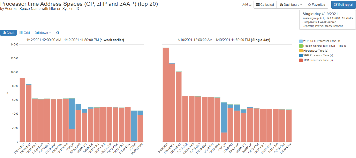

Figure 5 shows another way you can compare CPU consumption from one day to another, for the top 20 address spaces. I like to do a quick check both ways, since some issues may be easier to spot in one format vs. another. For me however, the intuitive ease-of-use of the area charts is hard to beat.
Figure 5: Comparison of daily CPU time for top 20 address spaces
Tip: At IntelliMagic, our consultants review charts like these as one element of proactive performance reviews. We typically do a daily review comparing a current day vs. one week ago. We compare Monday to Monday, Tuesday to Tuesday, etc., so that business workload patterns are comparable. We adjust for anomalies such as month-end or holidays and follow the data as needed, but comparing to the same day one week ago is a great place to start.
