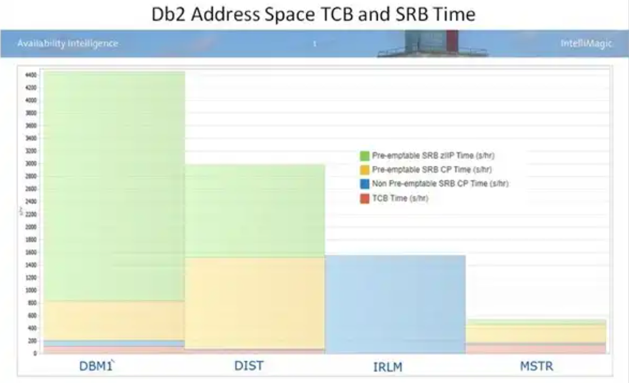

The four basic address spaces used by Db2 use CPs in different ways. The Database Services address space (DBM1) is responsible for managing the datasets used by Db2. In Figure 1 we can see that most of the time is spent in preemptible SRBs that run on zIIP engines. This indicates that buffer pool processing for prefetch and deferred write, as well as castout and log read/write operations, are executing on zIIP engines, which is good.
Figure 1 - IBM Z IntelliMagic Vision for z/OS dashboard showing Db2 Address Space TCB and SRB Time
In the DIST address space, which handles work entering the system via DDF, we see that work is divided almost equally between preemptible CP time and zIIP time. That is because up to 60% of SQL coming from distributed sources is zIIP-eligible. If this ratio were more CP-heavy, it might mean that you are waiting for zIIPs, and this situation should be researched at your site.
The IRLM address space takes care of Db2 locking, and therefore is uniquely non-preemptible.
Finally, the System Services address space (MSTR) is responsible for the management of threads, among other things, and will generally have a mix of the different processor types. Active log reads/writes, performed by the MSTR, can be up to 100% zIIP-eligible. However, archive log reads/writes execute under TCBs and are not zIIP-eligible. Higher TCB times may indicate that having more and larger logs would be helpful. By having larger active logs, archiving is needed less frequently, and reading from the archives would be much less likely in the event of an application rollback.
High MSTR SRB times may be helped by the use of protected threads and high-performance DBATs (more on that later). Since thread creation is handled by SRBs in the MSTR address space, your use of protected threads and how it relates to overall thread creation affects this value. IBM's recommendation is that the MSTR TCB time should be low compared to the SRB time, but they do not give a target ratio.

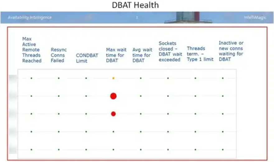

A product like IBM Z IntelliMagic Vision for z/OS can produce reports that show where the pain is in your distributed processing. Figure 2 shows that several data sharing groups are having problems with DBAT wait time. But fortunately, MAXDBAT and CONDBAT have not been exceeded. A further look into the wait time for DBATs would be needed.
Figure 2 - DBAT-Related Key Metrics

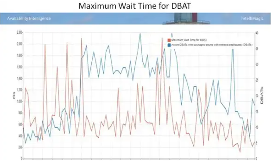

There is a particular type of DBAT called a High Performance DBAT. This involves a connection where the DBAT, once the transaction has completed, does not immediately go back into the DBAT pool, but remains persistent, waiting for another transaction to reuse it. It is enabled by the use of the RELEASE(DEALLOCATE) bind parameter and the CMTSTAT(INACTIVE) zparm. This greatly reduces the need for CPU to allocate the same resources and acquire the same locks over and over for the same type of work. High performance DBATs will hold onto those resources for 200 units of work, and then terminate.
Figure 3 demonstrates the effect that high performance DBATs can have on DBAT wait time. During the period of time the high performance DBATs are in effect, the maximum wait time for DBATs is lower. There is a tradeoff, however; since resources are held until thread deallocation time, there is a small chance of timeouts for other applications that want access to those resources. Also, utilities are prevented from breaking in to do work. High performance DBATs can be turned on and off by a Db2 command: -MODIFY DDF PKGREL(COMMIT) to turn off; -MODIFY DDF PKGREL(BNDOPT) to return packages to their original bind release option. Proper analysis of the use of high-performance DBATs and the particular applications that need to use them should be done by keeping an eye on the statistics and tuning appropriately.
Figure 3 - Monitoring DBAT Wait Time
