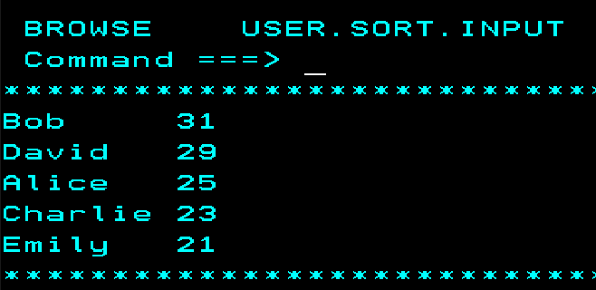

For demonstration purposes, let's assume that we have a sequential data set that contains a list of names in one column and the corresponding age in the second column. We would like to sort the data set based on age in descending order.
Normally, we would write a JCL to execute DFSORT on that particular data set. Something like this perhaps:

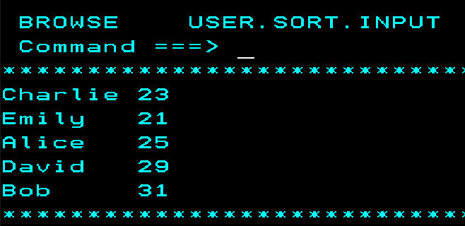

And that is it! We can see that DFSORT was executed and the data set has been sorted.
