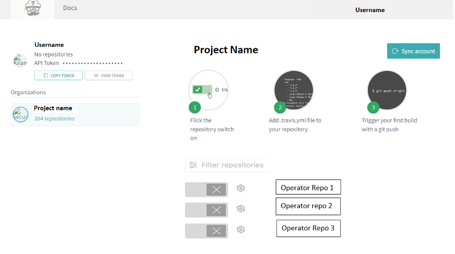

      3.        Then you will be able to see all the organizations and its repositories on the Travis dashboard
      Now Below are the steps to get started with the TravisCI:

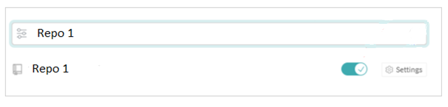

Step 1:- There is a search bar on the left side of the travis dashboard. Where you can search for the required builds using repository name
Step 2:- Clicking the + sign below the search bar. After clicking it you will be able to see the list of your existing repositories  if you have already connected your GitHub account.
Step 3:- Once the list of your project appears then search for the required project and click the enable switch in front of that repository name. Then travis will be able to trigger the build automatically after making some changes in repository.

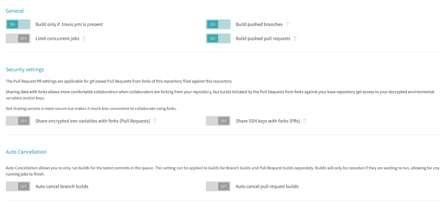

Step 4:- After it is enabled, then go to the settings by clicking the gear icon beside the check button. Now you should see different settings. So you can check all the options and change based on the project build requirements.

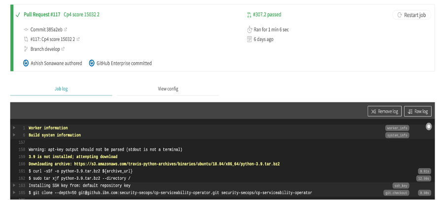

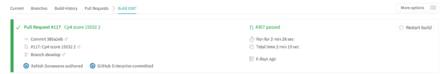

      Travis will trigger the build immediately after you push any changes to the repository. And the triggered build will be visible on travis dashboard as shown in below image

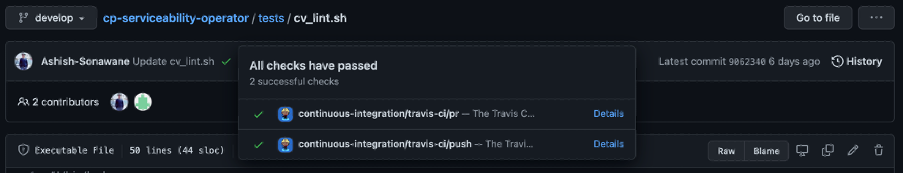

      You will also be able see the triggered build on the GitHub as well on the same changes file page. And after clicking in the details button it will redirect you to the same travis build page where you can check the logs.
      Also you will be able to see the logs on the same page below the summary section as below

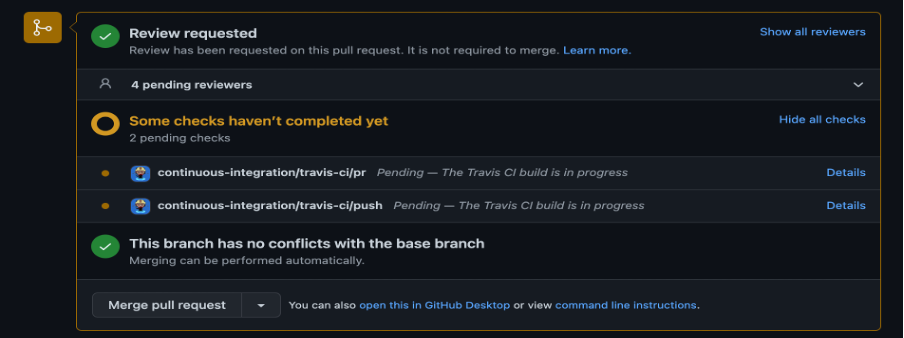

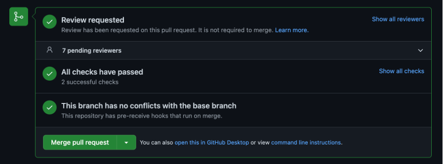

      In the case of a pull request,  the moment you raise a pull request from your branch to develop or master branch then this execution gets started and it sets as a mandatory check in GitHub. As long as the execution is in-progress you will not be able to merge the PR.
      Here the build is in-progress

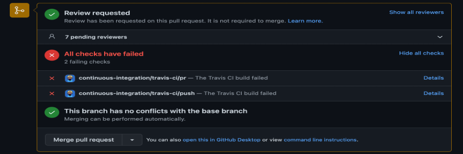

      If the build is failed then you will not be able to merge these changes.
      And once the build returns the success status from travis to GitHub then the merge button will be enabled and those changes are considered to be the valid and can be merged with the master branch as shown in the image below
