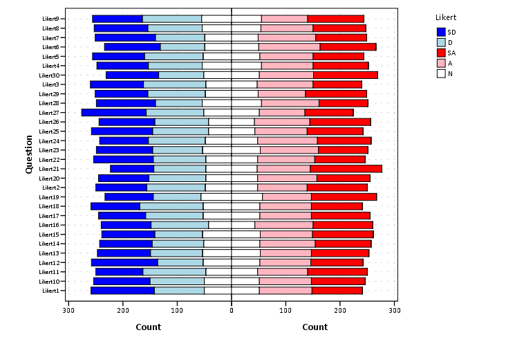

From here it is the same chart as before, just with the neutral category mapped to white.
GGRAPH
/GRAPHDATASET NAME="graphdataset" VARIABLES=Question COUNT()[name="COUNT"] Likert panel
MISSING=LISTWISE REPORTMISSING=NO
/GRAPHSPEC SOURCE=INLINE.
BEGIN GPL
SOURCE: s=userSource(id("graphdataset"))
COORD: transpose(mirror(rect(dim(1,2))))
DATA: Question=col(source(s), name("Question"), unit.category())
DATA: COUNT=col(source(s), name("COUNT"))
DATA: Likert=col(source(s), name("Likert"), unit.category())
DATA: panel=col(source(s), name("panel"), unit.category())
GUIDE: axis(dim(1), label("Question"))
GUIDE: axis(dim(2), label("Count"))
GUIDE: axis(dim(3), null(), gap(0px))
GUIDE: legend(aesthetic(aesthetic.color.interior), label("Likert"))
SCALE: linear(dim(2), include(0))
SCALE: cat(aesthetic(aesthetic.color.interior), sort.values("1","2","5","4", "3"), map(("1", color.blue), ("2", color.lightblue), ("3", color.white), ("4", color.lightpink), ("5", color.red)))
ELEMENT: interval.stack(position(Question*COUNT*panel), color.interior(Likert),shape.interior(shape.square))
END GPL.

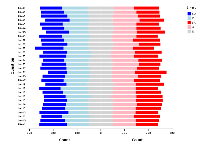

The colors are chosen to illustrate the ordinal nature of the data, with the anchors having a more saturated color. To end I map the neutral category to a light grey and then omit the outlines of the bars in the plot. They don't really add anything (except possible moire patterns), and space is precious with so many items.
GGRAPH
BEGIN GPL
SCALE: cat(aesthetic(aesthetic.color.interior), sort.values("1","2","5","4", "3"), map(("1", color.blue), ("2", color.lightblue), ("3", color.lightgrey), ("4", color.lightpink), ("5", color.red)))
ELEMENT: interval.stack(position(Question*COUNT*panel), color.interior(Likert),shape.interior(shape.square),transparency.exterior(transparency."1"))
END GPL.
