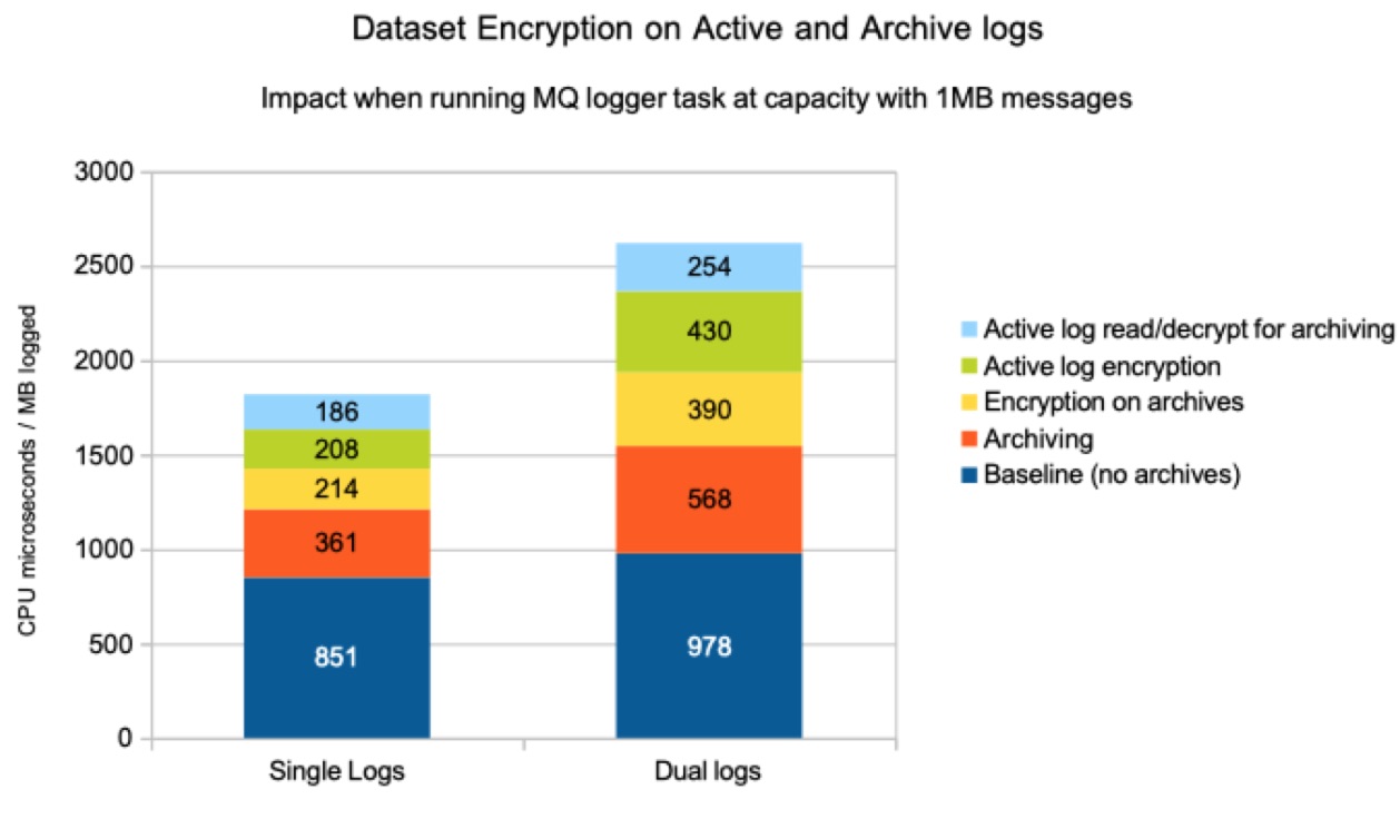

How do the costs look in context of a workload?
So far we have identified the additional cost to the MQ queue manager from adding data set encryption, but how does that appear when put into the context of a workload?
In this example we are running a workload that is driving workload to a fixed sustainable rate when logging 1MB messages. In our case this is driving the logs at 270 MB / second.
The workload is simple – 3 batch applications that put, commit, get, commit 1MB persistent messages for a set time. We know the rate of logging and can determine the MQ MSTR costs from the RMF Workload Activity report.
For this particular workload, the queues are always low depth and there is minimal activity at checkpoint – therefore the cost of page set encryption is negligible, and thus not included.
The following chart indicates the cost of processing 1MB of data logged in the MQ MSTR address space.
Notes on chart:
- The cost in the MQ MSTR address space for logging 1MB of data when configured with dual logs was 978 CPU microseconds.
- Enabling archiving added an additional 568 CPU microseconds per MB, for a total of 1566 microseconds.
- Applying data set encryption to the archives added a further 390 CPU microseconds, for a total of 1956 CPU microseconds.
- If data set encryption was subsequently applied to the active logs, a further 684 microseconds would be added, giving a total of 2640 CPU microseconds per MB. This additional 684 microseconds includes the active log encryption plus the active log read/decrypt for archiving.
- If dataset encryption was applied only to active logging but archiving is enabled, the cost would be 978 + 568 + 430 + 254, for a total of 2230 CPU microseconds.
