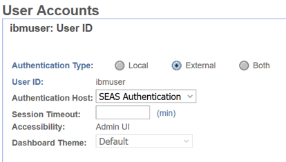

Then, change the user authentication from “LDAP” to “SEAS” in B2Bi. Here is the screenshot of the modified user authentication of “ibmuser”:
