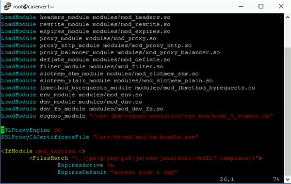

I will customize the certificate values in /etc/httpd/conf.d/ssl.conf
ssl.conf 1
And I will Include the cognos.conf in the virtual host
ssl.conf 2

We are going to configure this next. Open the Apache configuration for IBM Cognos Analytics. In my case I am including a standalone file (based on the shipped templates from <ca_install>/cgi-bin/templates) to my Virtual Hosts which contains all Cognos related configuration.
vim /etc/httpd/conf.d/cognos.conf
I will add the following Lines just after my module imports:
SSLProxyEngine On
SSLProxyCACertificateFile "/etc/httpd/ssl/ca-bundle.pem"
Then I will change the URI‘s that point to the Application Tier‘s from http to https
Apache configuration file cognos.conf
Now we need to create the file /etc/httpd/ssl/ca-bundle.pem which will contain the complete chain of trust (Root CA and intermediate CA)
cat cacert.pem icacert.pem > ca-bundle.pem
Create certificate chain file
Let‘s restart Apache and try it out.
systemctl restart httpd
Gateway is working
That‘s it. Our optional Gateway is now able to access the Application Tier‘s.
