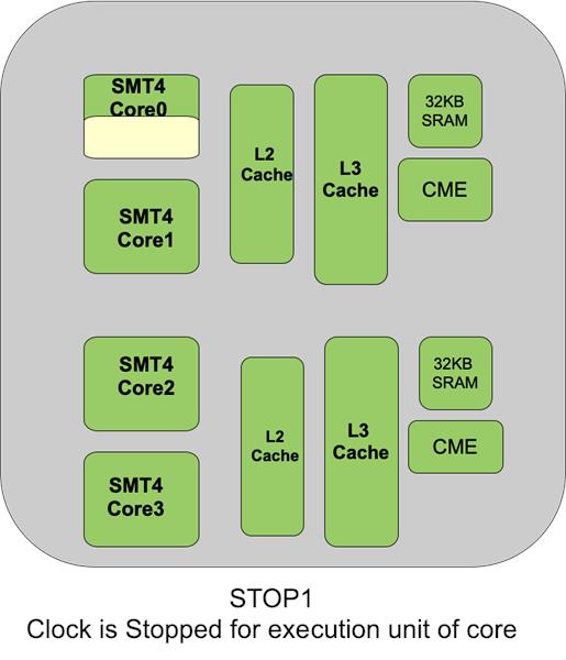

STOP1
Clock is stopped for execution unit of core
STOP1 is the most widely used STOP state by PowerVM. It is equivalent to the legacy "Nap" state however, it is more power efficient. STOP1 saves about 25% of power consumed by a core. It is very time efficient to enter and exit STOP1. Both entry and exit is handled completely in hardware with no intervention required by firmware. In this STOP state, both core and cache remain powered on. However, units of the core responsible for instruction fetch and execute are clocked off. Hence, the core stops executing instruction but remain accessible to the service processor and other service engines within the processor chip. It takes few microseconds to exit STOP1 state and does not require assistance from the any of the power management on-chip offload engines.

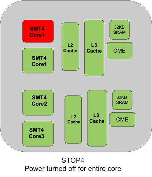

STOP4
Power turned off for entire core
STOP4 is equivalent to the legacy "Deep Sleep" state. In this stop state, the entire core is powered off. As a result, there is some state loss. However, timing facilities are maintained. This is different from POWER8 where at the equivalent idle state the timing facility was not preserved. Since, the core entering STOP4 and other deeper STOP states lose state, it is executed by the Hypervisor. The Hypervisor or equivalent must restore the state while waking up the core. In the wakeup path, after powering up of the core, it needs to go through a lengthy initialization and state restoration steps. STOP4 wakeup latency is in a range of 250 - 350 microseconds. The exact latency depends on a number of factors like frequency of operation, state of core and cache at the time of request, etc. STOP4 transition is managed by firmware. As a result, exiting STOP4 takes significantly more time compared to exiting STOP1 or STOP2. However, STOP4 is able to save about 60% of power consumed by the core. If energy management algorithms see no real work for a core for a significant period of time, the core is ideally suited for STOP4.

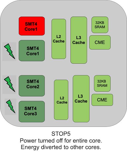

STOP5
Power turned off for entire core. Energy diverted to other cores.
STOP5 is quite commonly used STOP state for saving power by PowerVM/AIX based systems. Compared to STOP4, STOP5 does not save any additional power. Instead it adds Workload Optimized Frequency (WOF) to the picture. WOF enables any active running cores to run at a higher frequency by utilizing the energy saved from powered down core. This enables running cores to maximize performance while maintaining thermal stability. WOF uses a complex algorithm and requires coordination between multiple power management service engines which makes STOP5 entry and exit latency higher compared to STOP4.

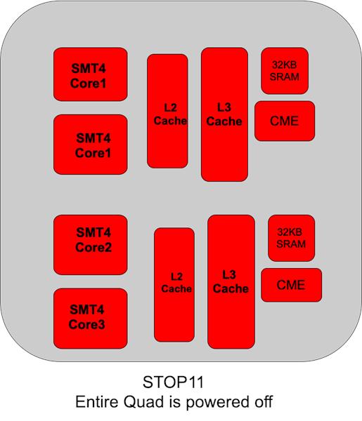

STOP11
Entire quad is powered off
STOP11 is deepest STOP state implemented in POWER9. It saves the entire core and cache power. STOP11 is a quad level STOP state.  It means a standalone core cannot enter STOP11. A quad can enter STOP11 only if all cores within quad can enter STOP5. This enables two L2 units shared by a core pair each and an L3 shared by all four cores to be powered off. As a prerequisite, all power management operations ( Service engines, P-State, WOF ) are turned off on the quad. These action involve coordination between multiple power management service engines. As a consequence, it takes a minimum of 75 microseconds for a quad to enter STOP11. On the wake-up path, cache and core needs to be powered and clocked. Various service engines needs to be restarted. Cores and cache needs to be reinitialized. It therefore takes a minimum of 5ms for a quad to wake-up from STOP11. The longer recovery time makes it inappropriate to use STOP11 for run time operation. Bare-metal Linux systems do not use STOP11. PowerVM based systems use STOP11 for product features like un-licensing cores and capacity on demand. It is also utilized in features like concurrent code initialization and memory preserving initial program load (MPIPL).
