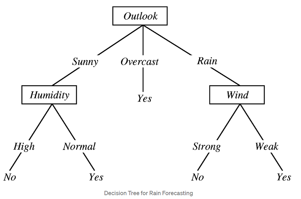

Binary Tree
Binary tree is used for both classification and regression usecases.
In this , the algo searches the all possible tests to find the one that is more informative about the target variable
The Decision tree is splitted at each node , can be taken as splitting the data that is current being considered across one axis.
The repetitive partition continues until each leaf in tree has a single target value( A Single Class / Single regression Value).
The leaf of the Tree that contains datapoints that all share the same target value is called pure
