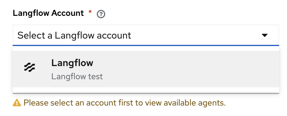

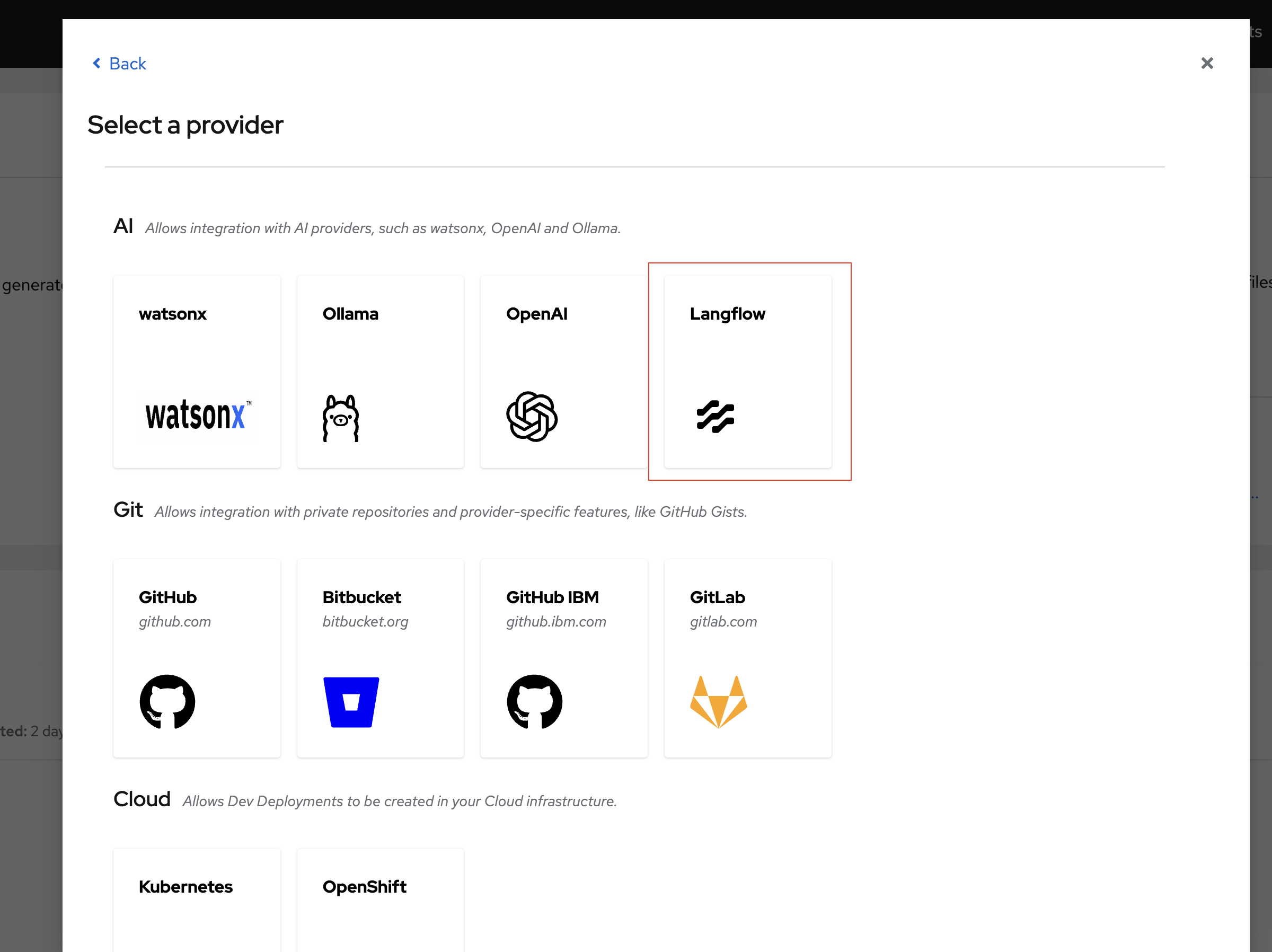

  1. Click the profile icon in the top right corner of Canvas.
  2. Select "Connected accounts" from the menu.
  3. Choose Langflow from the list of AI providers.

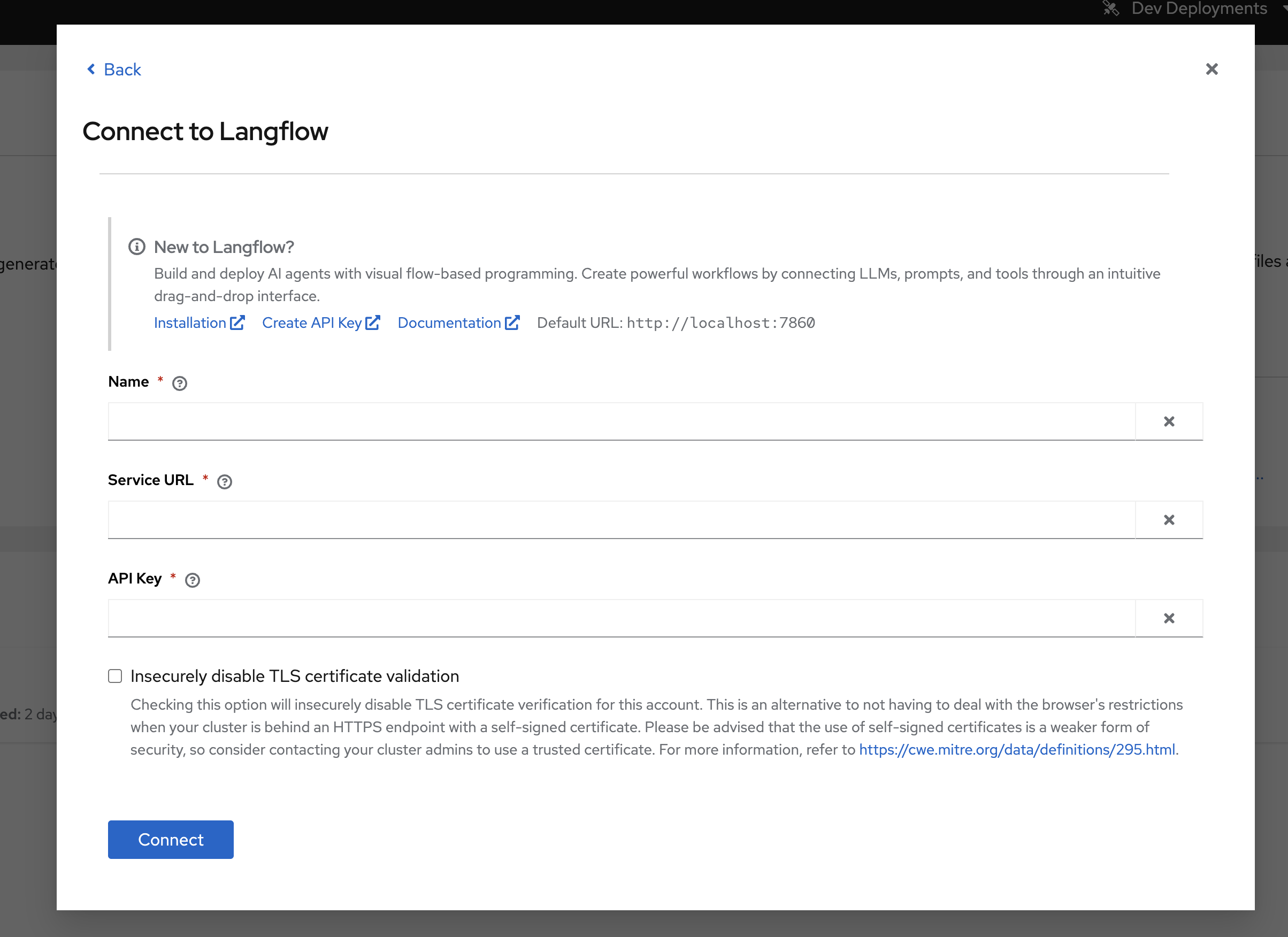

  4. Enter a display name, your Langflow Service URL, and API Key.
  5. Click "Connect" to save your account.

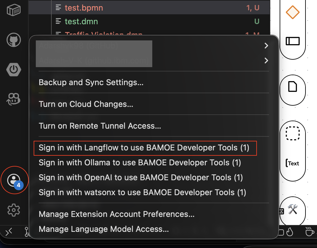

Step-by-step setup in Developer Tools for VS Code:
  1. Click the profile menu in the bottom left corner of VS Code.
  2. Select Langflow as your AI provider.
  3. Enter your Langflow Service URL and API Key.

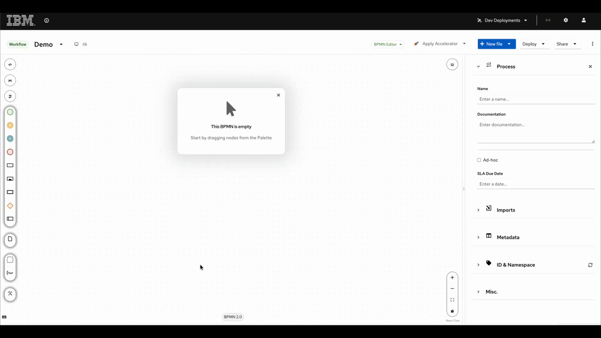

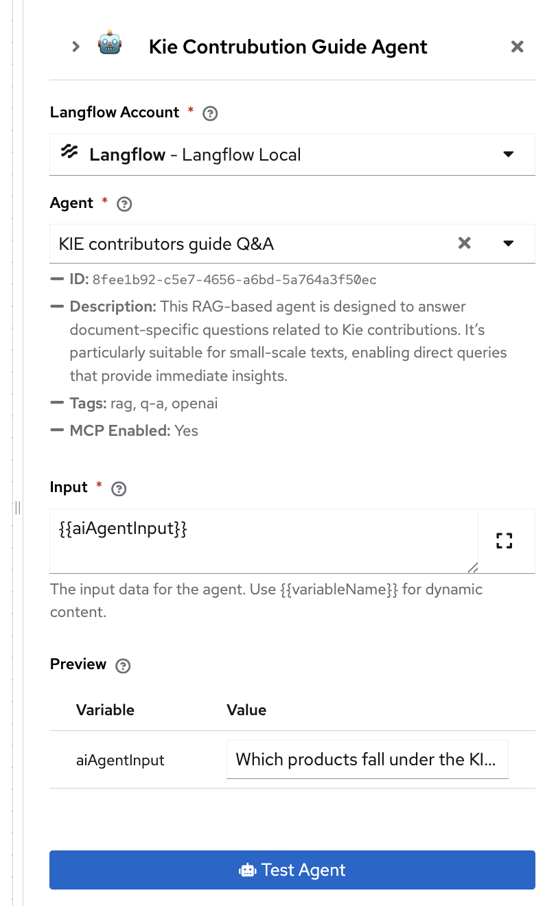

  1. Drag and drop the AI Agent Task node onto your BPMN diagram.
  2. In the property panel, select your connected Langflow account.

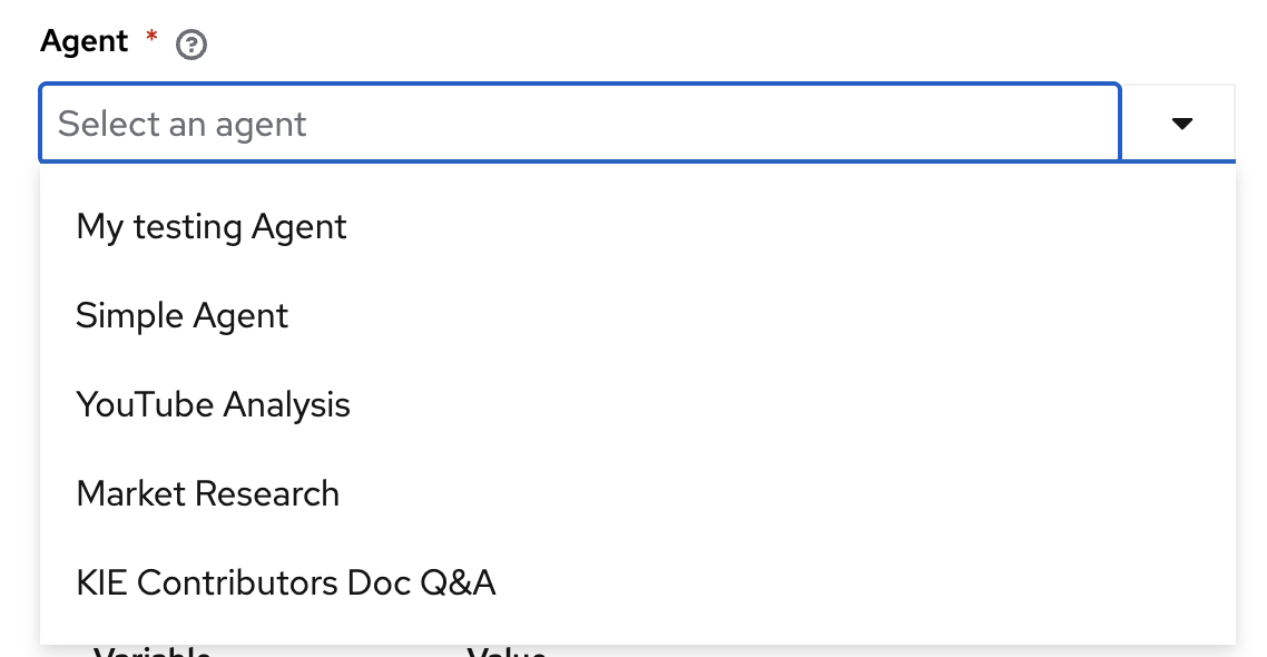

  3. Choose the agent or flow you want to use from the dropdown, or enter the Agent ID directly.
  4. View details about the selected agent, such as its ID, description, tags and MCP enabled.

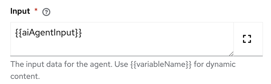

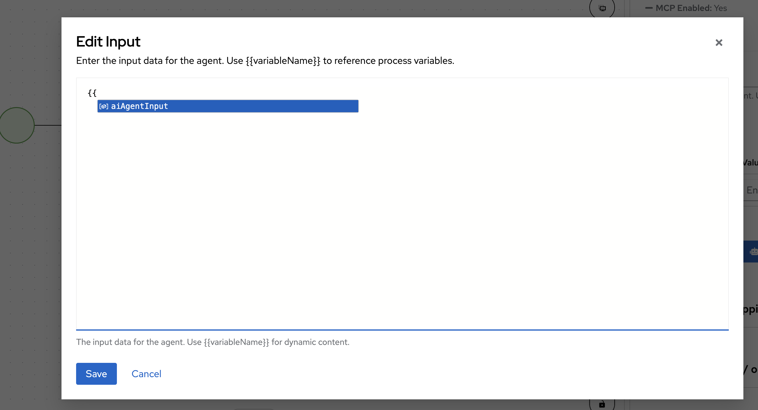

  5. Provide input for the agent. You can use the default aiAgentInput variable, and include process variables using {{variable-name}} format.
  6. Use "Advance Mode" in the input field for syntax highlighting and auto-suggestions for variables (press Ctrl+Space or Cmd+Space).

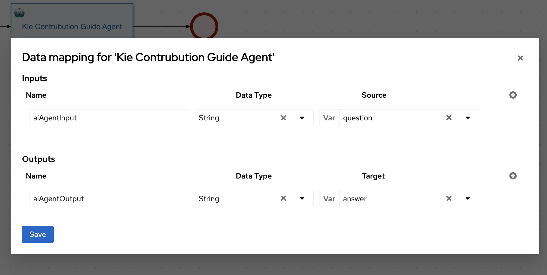

  7. Set up input and output data mapping as needed. By default, aiAgentInput and aiAgentOutput are used, but you can add more variables.
  8. Use the Preview Table to test your input variables with temporary values.

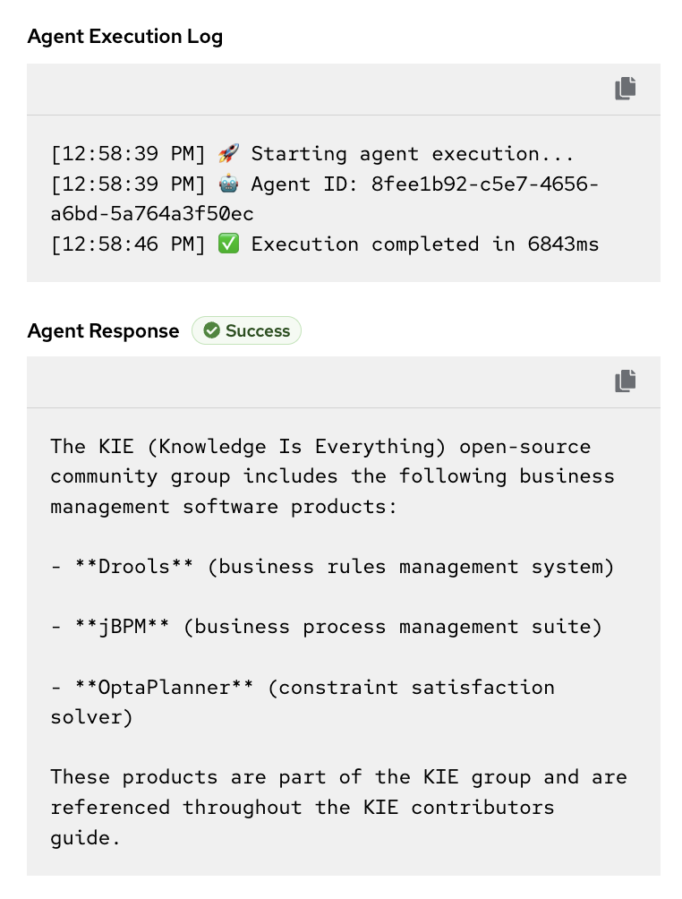

  9. Click "Test Agent" to run the agent and see the output in real time. Adjust your input as needed until you get the desired result.
