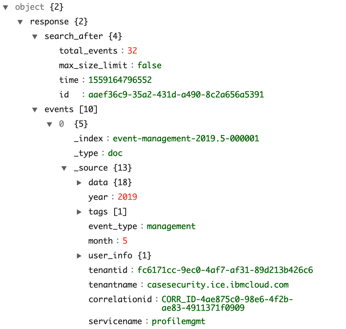

Scenario 1 / Get all events
The simplest call to make is get all events from the platform without filters. Though in larger environments, you will likely get over 10,000 records. We'll discuss handling pagination in a later section.
API Endpoint: GET /v1.0/events
Make the call:
curl -X GET \ https://mytenant.ice.ibmcloud.com/v1.0/events \ -H 'Authorization: Bearer myAccessTokentzkhVdRO8FE6f08CTKny4AbUl18'
Expected response:
   "response":{
      "events":{
         "search_after":{
            "total_events":54,
            "max_size_limit":"false",
            "time":"1559156150862",
            "id":"def9ea72-30ce-4589-800a-7306e306ea2e"
         "events":[
               "geoip":{
                  "continent_name":"North America",
                  "country_iso_code":"US",
                  "country_name":"United States",
                  "location":{
                     "lon":"-97.822",
                     "lat":"37.751"
