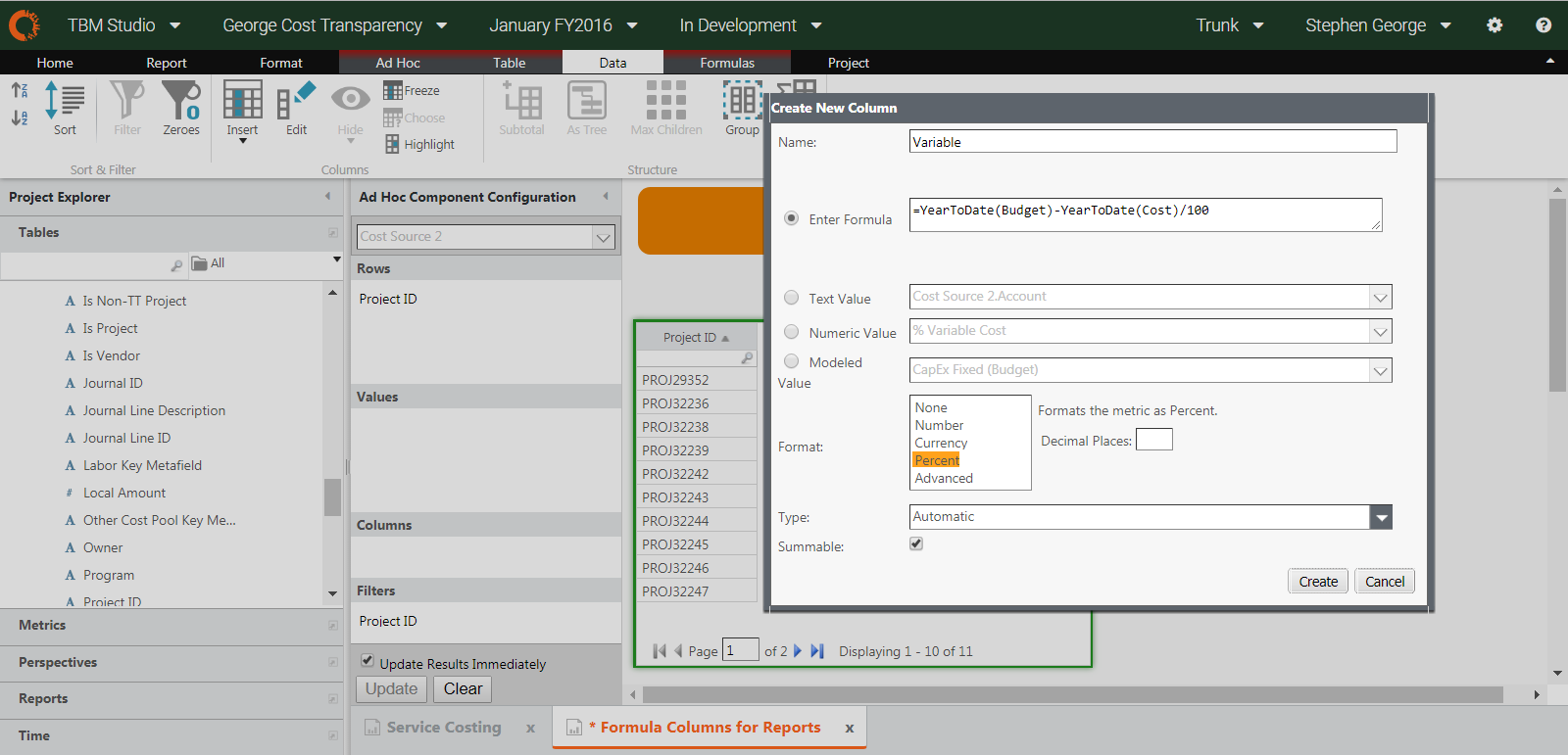

Scenario 2
Or, let's say you create a formula column and name it after an existing metric (This example uses “Variable” for the column name):
Adding Formula Column with same name as Variable metric
Because you are not using that same metric in the formula, the application allows you to create this column.
Then, you attempt to add another formula column that uses the actual metric ("Variable" in the example):
Adding Formula Column using Variable metric
In the resulting chart, the columns are automatically renamed and the values in your new formula column do not use the metric. Instead, the columns use the value from the previous formula column:

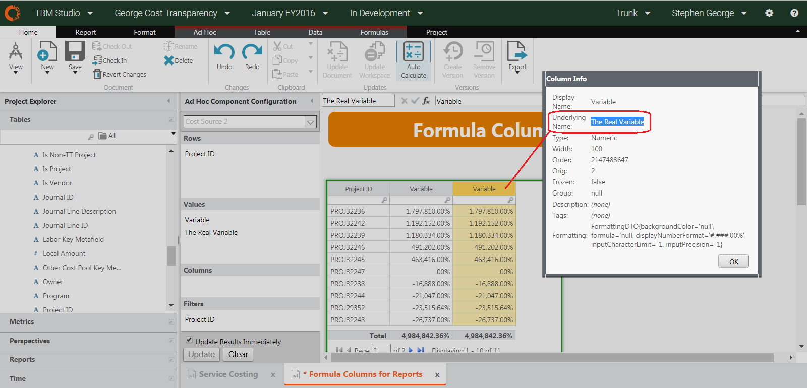

To see which column is the new formula column, right-click on the column header and select Show Info:
Show Info
To correct this, remove the formula column that uses the metric for its name and re-create the column using a different name (not the metric name). Note that by simply renaming the column, you will only change the name on the surface, and the Underlying Name will still be used in subsequent formula columns.
