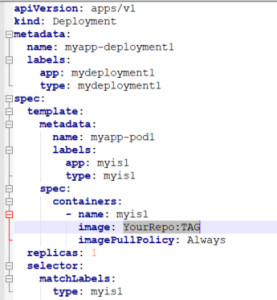

To deploy MSR, please refer to the attached deployments templates (2 deployment templates for 2 MSR)
deploymentofMSR1.yaml and deploymentofMSR2.yaml are present inside the attached zip
You can apply the deployment template using kubectl apply -f deploymentofMSR1.yaml. You will have to run this individually for 2 deployments. Make sure to update the template with correct image url.
