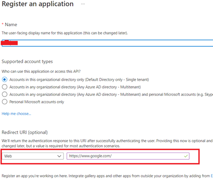

Navigate to Active Directory and register the application as below. Configure the redirect URI. This will later be used to generate auth code.

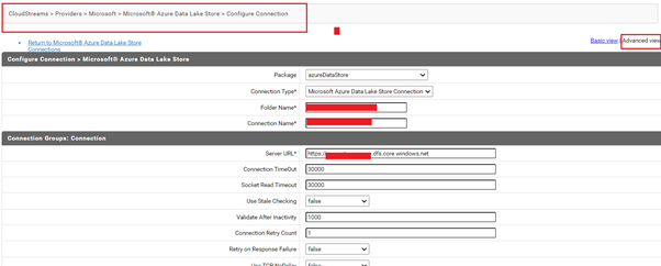

STEP3: Integration between webMethods Integration Server to cloud Azure Data Lake Store to create a .txt file
Navigate to IS administrator in your browser as below. This will open a new tab,
In the new tab navigate to Providers>Microsoft>Microsoft Azure Data Lake Store
Ensure the version is 2.
Create a new connection with all the required parameters,
Save the newly created connection and enable it.
Now the connection is successfully configured.
