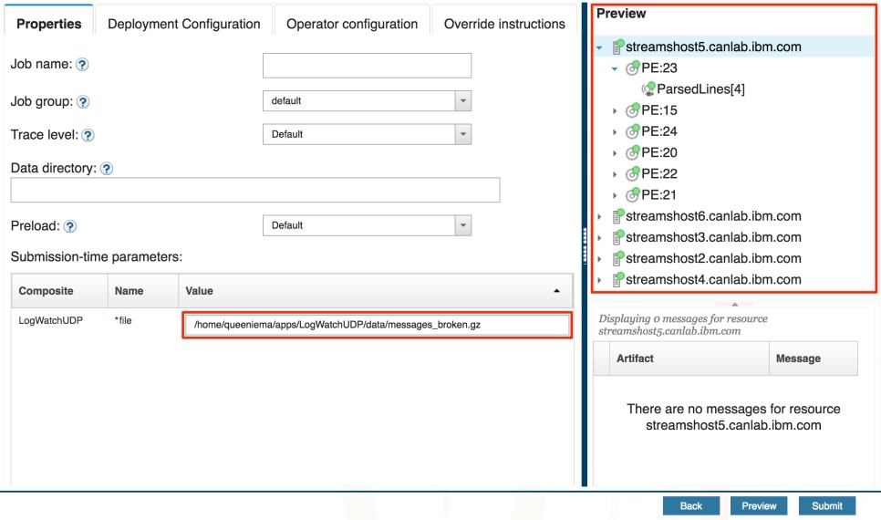

You’ll see the job configuration page, and I’ll explain each section in more detail later in this article. For now, I would like to start by previewing the job submission to see the number of operators, how operators will be fused together and placed on PEs, and any requirements that need to be met before submitting the job. Click on the Preview button in the bottom right corner.
An error message is displayed which notifies us that we are missing a required submission-time value called file.
This value should be a path to a log file, and to bypass this error, we can specify the path to the messages_broken.gz file that is included when you download the application from GitHub. In my case, the log path is: /home/queeniema/apps/LogWatchUDP/data/messages_broken.gz. With that, let’s preview the job once more. Now, we see that there are no errors. If we were to submit the job as is, the preview results show that there would be 27 operators grouped into 14 PEs and placed on 5 hosts.

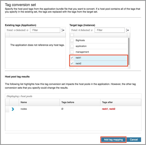

Now, let’s focus on the bottom portion of the screen. We can use the Convert host pool tags parameter to assign the rack1 and rack2 tags to the default host pool, thereby fulfilling the fifth requirement. Click on the Add button to create a tag mapping.
On the left, we see the tags defined in the bundle (there are none for this particular application), and on the right, we see the tags in the instance. To create a tag mapping, select zero or more tags from the left (corresponding to the originalTagSet in a job configuration overlay file), and one or more tags on the right (corrseponding to the targetTagSet). If no tags are selected from the left side, then it indicates that the default host pool (which has no tags) is the target of the conversion. In this case, that’s exactly what we want. Since there are no tags to select from the left (and we do not want to select any), I will leave it as is and only select rack1 and rack2 from the right side. In the bottom portion of the dialog, the new mapping is shown. Let’s complete the process by clicking on the Add tag mapping button.
Previewing a job submission
Now that we’ve adjusted the configuration parameters, we can preview the job submission to get a sense of what the job will look like once we submit it. Once again, it is successful and the results show that there will be 27 operators grouped into 7 PEs and placed on 3 hosts.
Let’s check to make sure that the requirements have been met. The full preview results are shown below. Note that the job properties in the first requirement are omitted in the preview panel.
