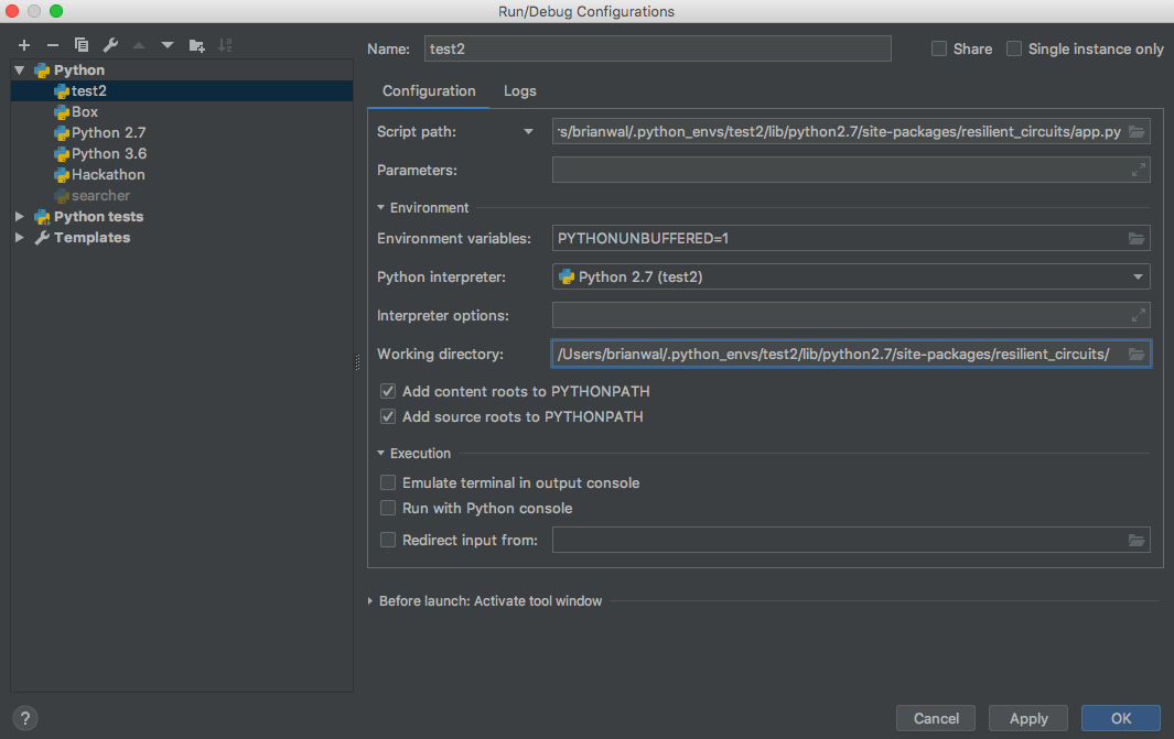

- Edit Configurations
- From the top menu bar click Run > Edit Configurations. You may need to hit run beforehand for this option to show up.
- In the top right of the popup click <g class="gr_ gr_970 gr-alert gr_gramm gr_inline_cards gr_run_anim Style multiReplace" id="970" data-gr-id="970">the </g>
<g class="gr_ gr_970 gr-alert gr_gramm gr_inline_cards gr_disable_anim_appear Style multiReplace" id="970" data-gr-id="970"> icon</g> to add a new configuration and choose Python.
- Name it whatever you would like.
- Python interpreter should be set to the Python environment you just created.
- Script path should be set to
~/.python_envs/<name of environment>/lib/<python_version>/site-packages/resilient_circuits/app.py
- Working directory should be set to
- Click OK
