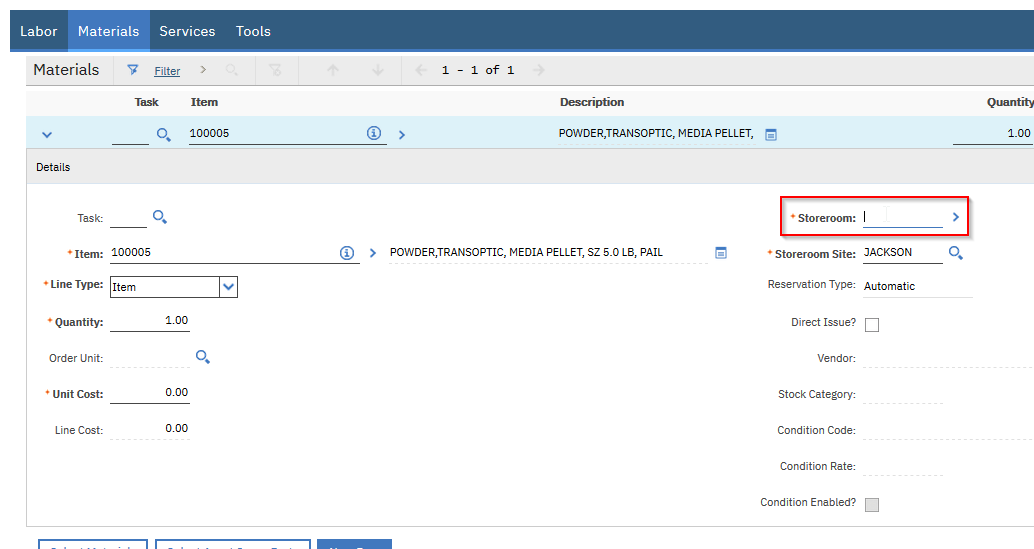

We have a requirement to force certain Items to be direct issue on Planned Materials. This plant has these parts in Inventory but they are not actually stocked. There is a field on the Inventory record we added to mark it as "DIRECT ISSUE". They want us to automatically mark these parts as direct issue if someone tries to add such an Item on a Planned Material line and fill out the Storeroom field. Here is where our script gets stuck:
Step 1) User enters the part number in the Item Field. Storeroom is empty but required.
Step 2) User enters the storeroom, tabs off and our script fires on the WPMATERIAL.LOCATION attribute. When this happens, there is an error that gets stuck in the storeroom attribute.
Maximo wouldn't show us this error nor would it get logged. So I figured out that if instead of manually typing in the storeroom, if I use the select value and choose it via the UI. I can see the error that is getting stuck:

I think this error arises because we just manually typed a storeroom into the storeroom field but then our script fires and sets the planned material line to Direct Issue
(directreq). At this point, Maximo is attempting to blank out the storeroom and storelocsite via it's normal logic tied to directreq but at the same time we also just set the storeroom via the UI. There has to be some conflict between those two situations causing that error?
