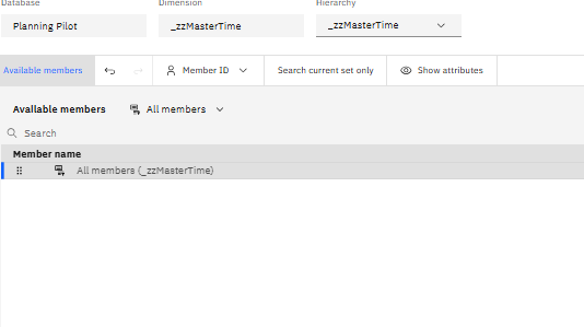

      This is what your main hierarchy looks like after your first process runs:
      Then in your second process you use:
      ElCnt = DimSiz(DimName);
      As your can see from the screen shot, the hierarchy (with the same name as the dimension) does not have any elements.  So the DimSiz is 0.
      For this code you would want to use:
      ElCnt = ElementCount( DimName, HierName);
