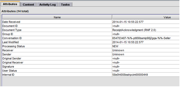

    Sometimes we are facing an issue due to unrecognized sender, receiver while processing ReceiptAcknowledgment (RNIF 2.0). Attached is the screenshot.
    My understanding
    Since Sender, receiver were marked unknown and this documents did not match the conversation and completed the model.
    Due to this process instance was re-trying to send the messages and failed after 3 retry with SendNOF.
    Screenshot of failed process instance also attached.
    Only below error messages is found in server log and activity log;

    Thanks Rakesh for quick response, actually BPM has not failed due to ACK.
    As ACK Messages was received but sender/receiver were marked unknown, Due to this ACK was not mapped to conversation.
    As result there were retry by the model to send messages and failed due to sendNOF.
    Here I believe the issue with TN not able to recognize sender/receiver.
    Note :- It is happening only 1 out of 20 times.
