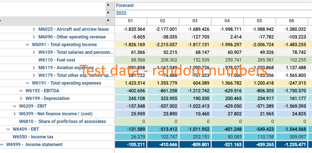

    Hi all,
    I wanted to share some feedback on a change I've noticed in PAW version 2.0.98 regarding conditional formatting for rows and columns. This update has made the process of applying conditional color formatting to specific levels in financial reports more complex. Previously, I used modest pastel colors to distinguish consolidated levels, and while there was room for improvement, the steps were fairly manageable. Now, however, it takes 14 clicks just to set up a conditional rule for a single row, which feels cumbersome and time-consuming.
    Here's the current process:
    1. Right-click on the row or column header.
    2. Select "Member Format" (this opens a dialog covering most of the workspace, so the data behind it isn't visible).
    3. Click on "Conditional Data Rules" from the left menu.
    4. Click "Add Rule +" on the right.
    5. Click on the "Type" column.
    6. Select "Member" from the dropdown.
    7. Click on the "Operator" column.
    8. Select "=" from the operator list.
    9. Click on the three dots at the far right.
    10. Choose "Edit."
    11. Click on "Fill Color."
    12. Select a fill color.
    13. Click "Done" on the bottom right.
    14. Finally, click "Apply" on the bottom right.
    With so many steps, the process has become tedious, especially for tasks that require frequent updates to formatting. Additionally, relying so heavily on mouse clicks is not very ergonomic. Excessive mouse usage can lead to strain and repetitive stress issues, impacting users' comfort and health over time.
    Suggestion for Improvement: Automated Coloring by Level
    To show how I use coloring to distinguish reporting levels, I've attached an example image below. It would be incredibly useful to have an option for automated coloring by hierarchy level, which would streamline formatting and make PAW even more effective for financial reporting.
    I hope the IBM-PAW development team considers this feedback and further explores ways to streamline the process.
    Thank you, PAW team, for continuously enhancing this tool - looking forward to seeing how it evolves!
    Asgeir Thorgeirsson
    Software Engineer, MS
    Icelandair
    Reykjavik

    Hi Asgeir,
    Agree that adding conditional formatting can feel like a lot of clicking now.
    In the short term and in context of your specific example though I assume how you have mentioned it that you are adding formatting to each row individually which would then be a lot of repetitive work; in cases like this you could streamline the work (and future proof for the event that new accounts are added to the rows in the future.)
    I would add an MDX member to the view in the version dimension (the one that has the "Forecast" element in your screenshot) which returns the level of the accounts (row) dimension e.g.:
    MEMBER
    	[Version].[Version].[AccountLevel]
    AS
    	[Account].[Account].CurrentMember.Properties("LEVEL_NUMBER")
    The MDX member will be calculated even though you don't need to show it in the view.
    You can then add all of your conditional formatting against the "Forecast" element based on what have is shown in the "AccountLevel" element - so assuming you only have 5 levels you would only need to add 5 rules as opposed to one for each account.
    It still wouldn't save the issue that each rule requires 14 clicks but it could reduce the amount of times you have to do those clicks!
