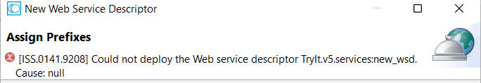

    What are trying to achieve? Please describe in detail.
    I got this error when i try to create a consumer for a webservice descriptor
    Below are the error stacktrace
    2022-07-20 10:19:49 ICT [ISS.0095.0042I] (tid=30) The ERRSTACKTRACE field in a WMERROR audit record was truncated. CONTEXTID: 37c5ecd3-d808-4a53-8ea2-0e875fa01d4a. MSGID: 3b800cc4-4ffb-29e5-65a4-7cb47612f22b. Full value: java.lang.NullPointerException: null

    Daily Bump, does anyone ever having this problem? the WSDL file successfully consumed in SOAP UI but i can’t consume it on my Designer, any other way?

    Hello @John_Carter4 cmsSng.xml are the main wsdl, i assume the other files need to be same directory, but it’s still failed

    I’m sorry that i forgot to mention that i changed the wsdl to xml extension, because i’m not able to upload wsdl files to this forum, it said invalid format iirc , but it’s the same file just with a different extension
