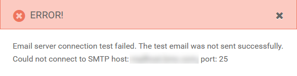

    In API Gateway | Administration | Destinations | Email configuration I define the various settings.
    Pressing the Test button results in:
    I’ve tested with and without defining various email fields, but always populating the test email (required).
    There is a single error message in the server log:
    [ISC.0077.0004E] Exception during pub.client:smtp, type: javax.mail.MessagingException, msg: Could not connect to SMTP host: xyz.nowhere.com, port: 25
    (hostname in the error string above is phony for this post)
