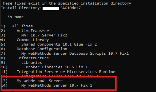

  • 4.  RE: Active Transfer version 10.7 activetransfer.log not updating
    Posted Thu August 05, 2021 12:51 AM
    Hi Paul,
    Sorry for the delay in response.
    This requires fix for ‘My webMethods Server’, not ‘My webMethods Platform Manager Plug-in 10.7 Fix 1’
    i.e. ‘My webMethods Server 10.7 Fix 1’.
    Please refer the screenshot shared.
    FixDetails
    This should resolve the issue.
    UPDATE:
    We have identified the same issue with MWS 10.7 Server Fix 1 as well.
    Fix for this issue will be available as part of MWS 10.7 Server Fix 2.
    If a test patch becomes available, will update this thread.
    Apologies for the earlier update.
