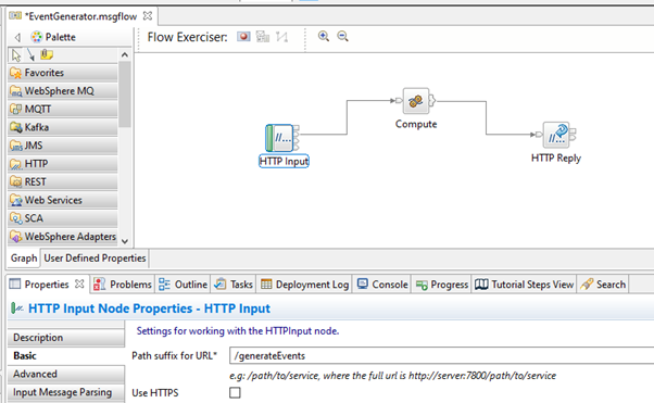

The Event table records can be generated with a simple EventGenerator flow using a Compute Node as shown below. Compute node is configured with Datasource name (ORACLEDSN) to connect to the Oracle Database.
 ESQL Code in the compute Node.
In the above ESQL code, we first get the total number of records in the EMPLOYEE table and then based on this number event records get inserted into EVENTS table for the DatabaseInput node.  We create one event record for 1000 rows in the table ie 1000 events for 1 million record.
