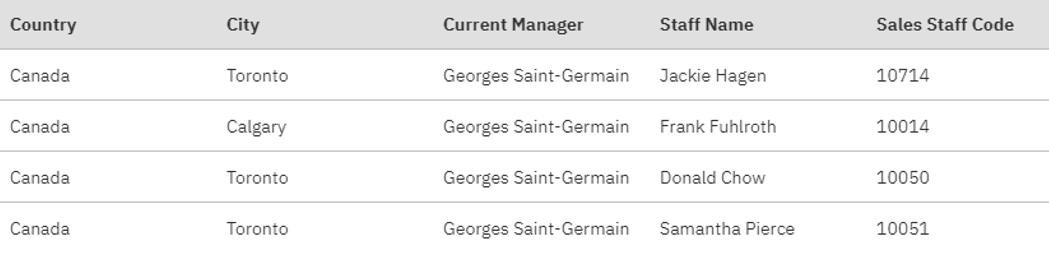

The Staff table looks like:

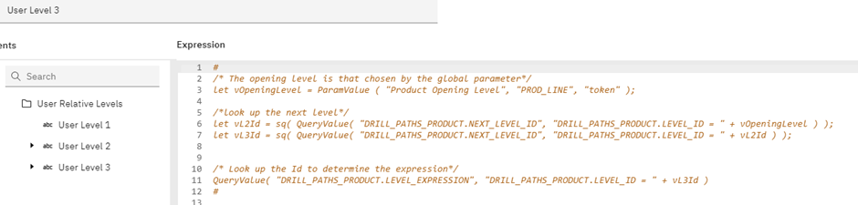

The essence of the solution is to create calculations on the product dimension that define User Relative levels for Level 1, Level 2 and Level 3 of the dimension based upon the global parameter. There are three levels as at the maximum the drill path is three levels deep ( Line > Type > Product).
These User Level calculations use the macro language.
The User Level 1 calculation is:
The ParamValue function is used to set the value of vOpeningLevel to that of the Product Opening Level global parameter. If this is not set, then the value PROD_LINE is used.
Using the QueryValue function we can return the LEVEL_EXPRESSION from the DRILL_PATHS_PRODUCT table for the vOpeningLevel. A reminder of what is being looked up, and what is returned.
(Any of the macros shown in this post could be written with nested functions, using the Let statement makes the code more readable.)
The User Level 2 calculation is a bit more complicated. Knowing Level 1, we can look up the NEXT_LEVEL_ID.
and with the NEXT_LEVEL_ID we can look up the appropriate column, just like we did for Level 1.
Level 3 is very similar.
If the global parameter is not set then these calculations return:
All levels are needed.
If the global parameter is set to PROD then these calculations return:
All levels are populated, even though they are not needed.

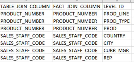

These issues are addressed in the drill path file/table. For a multi-table solution the drill path file looks like:
  1. DRILL_PATH.
    The table contains multiple drill paths. In this example we have a Product Drill Path and a (Sales) Rep drill path. This column helps us identify each.
  2. TABLE.
    This is the underlying SQL table that is used to create the new table.
    For the Product drill path, the PRODUCT table is used. For the Rep drill path, the STAFF table is used.
  3. TABLE_JOIN_COLUMN / FACT_JOIN_COLUMN
    How the underlying SQL table joined to the fact table. Which two columns join to each other.
  4. LEVEL_ID / LEVEL_ORDER / LEVEL_DISPLAY_NAME / NEXT_LEVEL_ID.
    The same columns as found in the single table technique.
  5. TABLE_COLUMN.
    The expression to create the level.

Multiple Tables with Different Join Types
This is an advanced topic for experienced data modellers!
In the example shown both Product and Staff join to the Sale table on a simple single column equi-join.  There may be scenarios where the join between the different dimensions to the fact.
Using the following example, I can explain how it can be resolved
  1. Product <-> Sales.
    Product.Product_Number = Sales.Product_Number
  2. Staff <-> Sales.
    Staff.Staff_Code – Sales.Staff_Code and
    Staff.Eff_Beg_Date <= Sales.Sales_Date and
    Staff_Eff_End_Date >= Sales.Sales_Date
    This type of join can often be found in a data warehouse between a fact table and a slowly dimension. It allows the fact to join to the Staff record that was current at the time the fact was recorded. This is instead of using the traditional Surrogate Keys. Data modules does not have a between function, hence the verbose nature of the join.
This example shows very different joins between the Product and Staff dimensions. How can our SQL version of either dimension cope with this?
A reminder that the join between tables cannot be changed. It is set in the user interface.
  1. We cannot change the cardinality or the filtering strategy.
    The chosen cardinality and filtering must be appropriate for both the Product and Staff dimensions join to the fact table.
  2. We cannot change the columns in the join.
    We cannot have the join change from one column (needed for Product) and three columns (needed for Staff).
  3. The only thing we can change is what expression is used within the columns used for the joins. And this was shown in the previous examples. Sometimes the expression was Product Code, and sometimes the expression was Staff_code. The joined columns remain static, but the expressions within those joined columns change.
The join has to cope with the worst-case scenario. In this case the join needs three columns joined with the appropriate conditions.
In the previous solution, the join between the fact table was on a single column. The drill path table contained the dimension and fact columns.
Now, the SQL query needs to create the three columns needed on the dimension side of the join. The fact side of the query needs to supply the one key and a date. The same technique can be used but with more columns in the drill paths table.
If the REP line is looked at, this defines the columns used in the join between the Sales fact and the Sales Rep dimension. As before, calculations are created on the queries that match to these columns – that is three calculations on the dimension query mapping and two columns on the fact query. The joins between these columns are defined.
For the PROD line, the same join works! Within the columns that are not used in the join literals are used that make this part of the join always true. In this case 1900-01-2 between 1900-01-01 and 1900-01-03.
