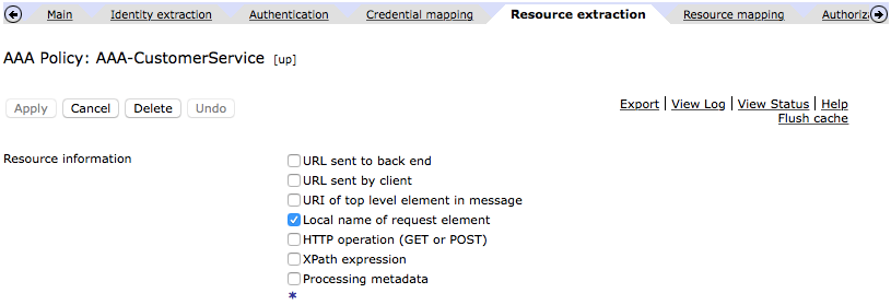

  5. In the “Resource extraction” tab, we will set as below. As you see we will extract the operation from the payload, to validate later against the AAA file.6-27_Leandro_Blog_3.png
