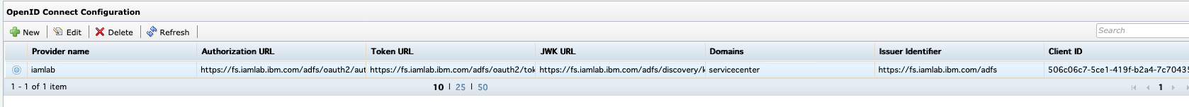

Now we can continue by setting up the External OIDC configuration in IGI.
Go in "OpenID Connect Configuration".
  1. Click New
  2. Set the provider name, in this configuration "iamlab"
  3. Set the "Configuration" to "Discovery Configuration"
  4. Enter the ADFS discovery URL, it should look like "https://<adfs-fqhn>/adfs/.well-known/openid-configuration ; replace <adfs-fqhn> with your ADFS endpoint FQHN.
  5. Set "Signature Algorithm" to RS256
  6. Set User ID to Create Subject to "upn"
  7. Enter the Client ID and Shared Secret obtained from ADFS team
  8. Select the checkbox "Service Center"
  9. Click Save configuration
  10. All fields will be populated
OIDC Config result
We are done, you can restart IGI
