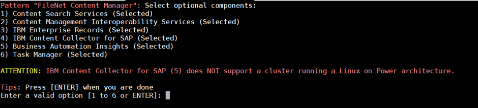

      5. Select optional components. For this blog we will select all 6 components
6. Press Enter to proceed

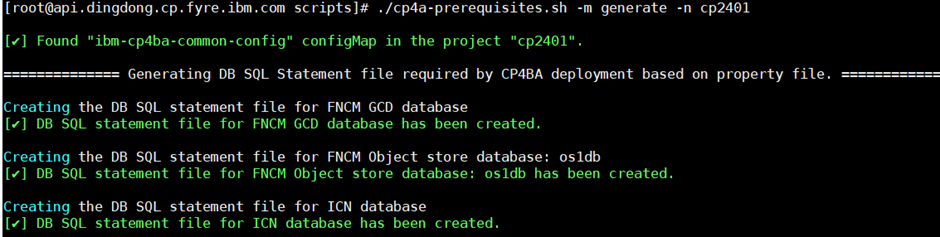

       17.  When the user property files are complete and ready, make sure that you are in the scripts folder under cert-kubernetes, and run the cp4a-prerequisites.sh script in the "generate" mode.
./cp4a-prerequisites.sh -m generate -n cp2401
    18. The user needs to create the databases … If DB selected is other than Postgres EDB. They need to run the DB scripts against the database servers.
