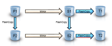

Remote Pair FlashCopy with Remote Backups
Cascading FlashCopy allows the use of Remote Pair FlashCopy in situations where it was previously not possible.
With Remote Pair FlashCopy, a FlashCopy command between two Metro Mirror source volumes is mirrored to the secondary volumes.

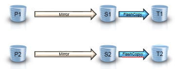

Now consider a Metro Mirror environment where FlashCopy is also used to make copies of the Metro Mirror secondary volumes at the remote site here:
Without Cascading FlashCopy, you cannot combine these two uses because mirroring a Remote Pair FlashCopy from P1P2 to S1S2 results in a cascaded FlashCopy relationship of S1S2T2. With the new capabilities of Cascading FlashCopy, however, new possibilities such as this are allowed.
