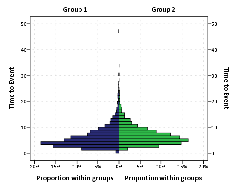

Sometimes you can't always get to what you want through the chart builder GUI though. For an example, I originally wanted to make a population pyramid type chart, and it does not allow you to specify the base percent like that through the GUI. So I originally made a pyramid chart like this;
And here is what the pasted output appears like.
GGRAPH
/GRAPHDATASET NAME="graphdataset" VARIABLES=time_event group MISSING=LISTWISE REPORTMISSING=NO
/GRAPHSPEC SOURCE=INLINE.
BEGIN GPL
SOURCE: s=userSource(id("graphdataset"))
DATA: time_event=col(source(s), name("time_event"))
DATA: group=col(source(s), name("group"), unit.category())
COORD: transpose(mirror(rect(dim(1,2))))
GUIDE: axis(dim(1), label("Time to Event"))
GUIDE: axis(dim(1), opposite(), label("Time to Event"))
GUIDE: axis(dim(2), label("Frequency"))
GUIDE: axis(dim(3), label("group"), opposite(), gap(0px))
GUIDE: legend(aesthetic(aesthetic.color), null())
SCALE: cat(dim(3), include("1", "2"))
ELEMENT: interval(position(summary.count(bin.rect(time_event*1*group))), color.interior(group))
END GPL.
To get the percent bins instead of the count bins takes one very simple change to summary specification on the
ELEMENT
statement. One would simply insert
summary.percent.count
instead of
summary.count
. Which will approximately produce the chart below.

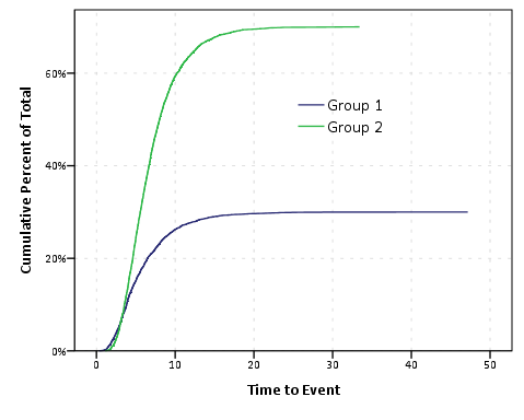

GGRAPH
/GRAPHDATASET NAME="graphdataset" VARIABLES=time_event COUNT()[name="COUNT"] group
BEGIN GPL
DATA: COUNT=col(source(s), name("COUNT"))
GUIDE: axis(dim(2), label("Cumulative Percent of Total"))
GUIDE: legend(aesthetic(aesthetic.color.interior))
SCALE: cat(aesthetic(aesthetic.color.interior), include("1", "2"))
ELEMENT: line(position(summary.percent.cumulative(time_event*COUNT, base.all(acrossPanels()))),
color.interior(group), missing.wings())
END GPL.
This is kind of helpful, but not really what I want. I wasn't quite sure how to change the summary statistic functions in the
ELEMENT
statement to calculate percent within groups (I assume it is possible, but I just don't know how), so I ended up just making the actual data to include in the plot. Example syntax and plot below.
