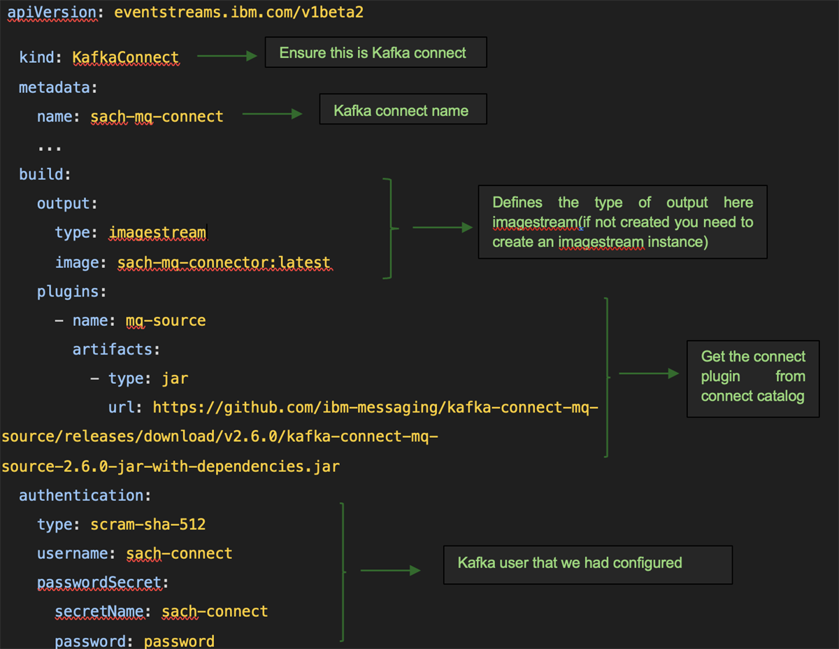

1.    Create the Kafka Connect cluster with MQ Source plugin. The major parts of the configuration that involve changes are highlighted here.
Refer to the connect catalog to get the proper type and url.
https://ibm.github.io/event-automation/connectors/kc-source-ibm-mq/installation
https://ibm.github.io/event-automation/connectors/converter-apicurio-avro/installation
2. Apply the configuration: oc apply -f mq-kafka-connect.yaml
3.Verify the Kafka Connect instance: (The expected status is to be READY)
oc get kafkaconnect <connect-cluster-name> -n <namespace>
Eg: oc get kafkaconnect sach-mq-connect-connect -n test-ns

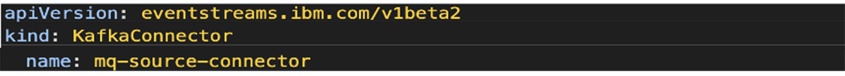

And as per our MQ definitions the connector YAML file should finally look like this:
This configuration uses the com.ibm.eventstreams.connect.mqsource.MQSourceConnector class to stream raw byte data (via ByteArrayConverter) from the DEV.QUEUE.1 queue on queue manager sachmq into the Kafka topic mq-sourcetopic. It connects via channel KAFKA.CONN.SVRCONN at endpoint sachmq-ibm-mq(1414), securely authenticating using a mounted credentials file. Built using DefaultRecordBuilder, the connector is currently running with one active task, with a customizable batch size of up to 250 messages.
5. If you are creating through oc CLI then proceed with the below command to apply the changes in the configuration:
oc apply -f mq-source-connector.yaml
6.  Verify the connector : oc get kafkaconnector <connector-name> -n <namespace>
Here: oc get kafkaconnector mq-source-connector -n test-ns
