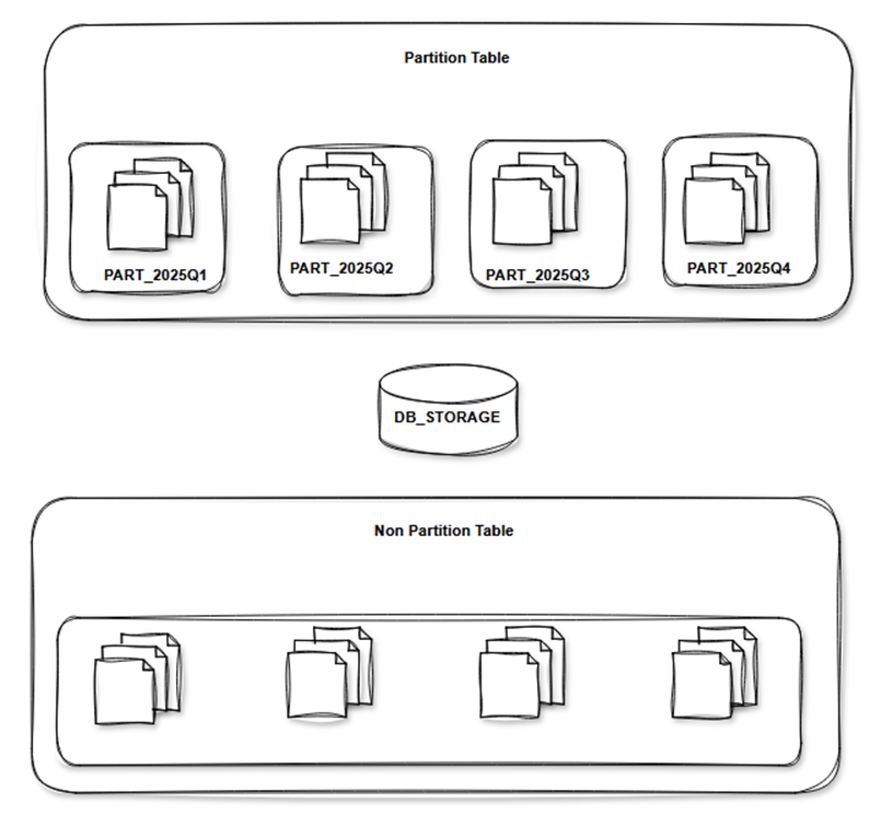

Press enter or click to view image in full size
Image shows difference in partitioned and non-partitioned tables where in partition one , there are multiple table spaces with its own pages while in non-partitioned there is single table space with multiple pages.

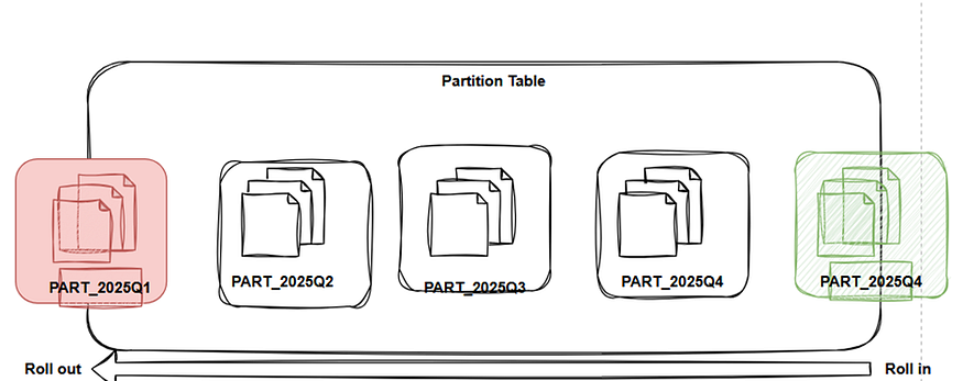

Leveraging Attach/Detatch for partitioning:
Assuming the table is partitioned by column — which is typically utilized in where conditions or those with date/time ranges — is required in order to accomplish the ease of management and administrative operations.
We can determine how many partitions are necessary once everything is finalized, and each partition may even belong to a separate table space. Instead of deleting a large amount of data from the table, we can choose to detach the partition from table.
Image shows detatch/attach of partition on a partitioned table.
Following is the syntax to do that:
ALTER TABLE table name DETACH PARTITION partition_name INTO another_tablename;
We can even attach a partition and set its integrity.
ALTER TABLE table name ATTACH PARTITION partition_name STARTING ‘<start_value>’ ENDING ‘<end_value>’ FROM another_tablename;
Since we have separate table space for each partition, It is an added advantage which results in easier management of detatched partition as new table and deal as per our requirements.

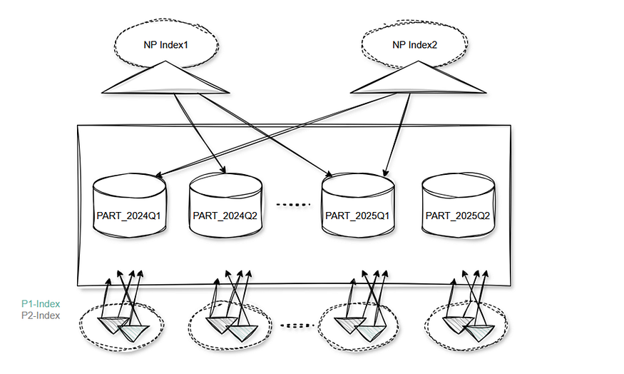

Optimized Index Usage: We can create local indexes per partition, reducing overhead and improving lookup times. Index rebuilds are faster when scoped to a single partition.
Image shows difference in accessing of table via portioned and non-partitioned indexes where partition one scans its own table space and non-partitioned scans all the table spaces.
