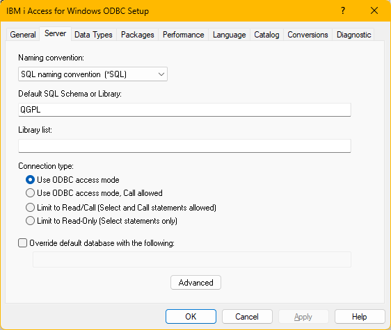

    Dear Kevin
    It depends on what connection method you use.  For example, for ODBC connection, you can set the library list in ODBC data source definition :
    But if you want different library list for different ODBC connection to the same data source, you can set it programmatically using connection string keyword DBQ: https://www.ibm.com/docs/en/i/7.4?topic=details-connection-string-keywords
