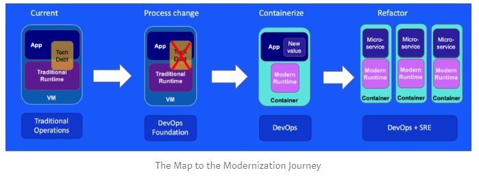

Let’s begin with a map of our modernization journey:
There are four different steps in this map of the journey. The thing you need to realize first is that each step is a potential stopping point for a set of applications. You may choose to move them on to the next step, or for some of them, they will stop at that step until they either reach end of life or are replaced with something else.
Stage 0: Current State
Stage 0 represents the current state of most enterprise applications, especially those written in Java. Your application is probably written as a Java monolith comprised of one or more EAR or WAR files, and is deployed on a traditional Java Application Server runtime such as WebSphere ND or WebLogic. You may have some automation to deploy your application, perhaps written with ANT or using the vendor’s deployment scripts, but the process for deployment, upgrade and management is at best, semi-automated.
The key realization here is that there will be some applications that will never leave their current state. There are several reasons why this would be true. #1 The application may have a limited lifetime. If you are going to retire an application, then there is no need to modernize it. #2 The application may be replaceable by SaaS. If the application (at least in its current form) can be entirely replaced by a SaaS application, then in many cases that is the simplest and easiest route. #3 The application may be one that is supported by a vendor or third party ISV that is resistant or even hostile to changing their implementation, automation or management. If that is true, then that should be a reason to start looking for other alternatives (SaaS or other…)
We would hope that the number of applications that fall into this category are small, but realistically, the number can be large. For companies that consider themselves to be “technology companies” this figure may be in the low double digits, perhaps 20–30%. However, for companies that explicitly do not consider IT to be part of their business competency (as often evidenced by large outsourcing contracts and wide reliance on packaged software) the number can be quite large — we have seen up to 80% in some companies that are part of mature industries. When costs savings becomes the driving force in IT and completely subsumes innovation, then this end state is nearly inevitable. When that is true, that may be an indication that this particular company, or perhaps the entire industry, is ripe for disruption.
As a side note, there is a single, thin thread leading to a way out — in some cases it may be possible to reduce overall TCO of the solution by doing a VM lift and shift to the public cloud. However, this is, at best, a tactical decision and not a strategic decision. If it makes sense to balance OpEx for CapEx for your particular organization, this can be valuable. For instance, in one client I am familiar with, they were facing a multimillion-dollar hardware upgrade charge from their datacenter vendor just for keeping their applications where they were. For them, avoiding this charge essentially made the business case for them to perform this move as the first step of a longer cloud modernization journey. But it was that longer journey that was critical to their strategic direction.

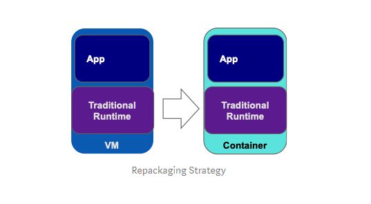

Repackage: Lift & shift to containers
The repackaging containerization approach is about repackaging existing application into a container with as little change as possible (preferably zero). Achieving zero application change also means preserving existing application runtime dependencies, such as a traditional application server runtime, which is required to support the older platform functionality used by the application.
For example, a WebSphere ND application running in a traditional WebSphere environment can be moved to a container “as is” using a container image that already contains traditional WebSphere. The ease of movement to containers using this approach is dramatically simplified when you use pre-built certified container images with a traditional WebSphere runtime (as are provided with the IBM Cloud Pak for Applications). However, while fast, this isn’t always the happy ending to your journey for modernizing Java EE applications. Let’s take a closer look to understand why.
Traditional Java EE runtimes like WebSphere have been designed as large monolithic application servers with full set of features always available, and typically have a long startup time measured in minutes and large runtime footprint. This creates certain limitations for using such containers in container orchestration platform such as Kubernetes where it is expected for containers to be routinely restarted and moved around. The high resource requirements will put constraints on node size and placement, and other aspects of planning your Kubernetes environment.
An even more critical requirement for sustainable containerization is to switch from the ‘pet’ to ‘cattle’ modes of operating applications in a container. This requires a substantial operational modernization effort to convert from high touch ‘pet’ type application administration using traditional administration console UI or ad hoc set of scripts to the use of fully automated CI/CD container deployment pipelines for ‘cattle’ approach. Our experience has shown that while it is possible to build automated pipelines to operate traditional Java EE runtime in container following ‘cattle’ model, it is not entirely seamless and comes with its own set of limitations.
So where does this leave us with repackaging containerization approach? Given the above considerations, for apps based on full-featured traditional Java EE runtimes this kind of “lift and shift” containerization should be considered primarily as a “plan B” that is only applicable when application change is not possible or desirable. That said, for Java and non-Java applications that do not have explicit dependencies on Java EE server runtimes, for example Java Spring Boot apps, the repackaging approach is more straightforward and is often the “plan A” option for containerization.
You can find a complete end-to-end scenario of the repackaging containerization approach for a traditional WebSphere ND application moved to Open Shift in the IBM Garage Architecture Center:
https://www.ibm.com/cloud/garage/architectures/application-modernization/op-modernization
A recorded walkthrough demo video of the process is also available here:
https://mediacenter.ibm.com/media/Cloud+Pak+for+Applications+-+WebSphere+Operational+Modernization/1_g46hm9ys

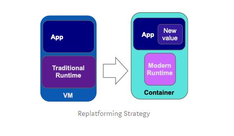

Replatform: Augment for Containers
This approach to containerization does not change the general intent of minimizing the application change required for containerization, but it allows you to fully realize the benefits of containerization and container orchestration platform by optimizing application runtime dependencies. In order to accomplish this, the traditional runtime used by an application, such as IBM WebSphere, is replaced with next generation modern container-native runtime such as Open Liberty, which is highly optimized for use in container environments with small footprint, fast startup and DevOps friendly infrastructure as a code configuration.
Replatforming an application to a container using a modern runtime makes it much easier to develop and demonstrate new value associated with application modernization. New value can come in multiple forms:
· functional augmentation based on ease of consumption of innovative cloud services facilitated by new application APIs provided by modern runtimes
· operational augmentation based on pre-built integration with common container services such as logs aggregation and analytics, monitoring and events, etc. provided by modern runtime
· development productivity augmentation with the capability to dynamically bring up and tear down container based testing environments quickly on demand
However, replatforming your applications from traditional Java EE runtimes to modern runtime such as Liberty, requires prioritizing your technical debt into those parts that are critical for the move, and those that are merely “nice to have”. The IBM Transformation Advisor is a tool that comes with the IBM Cloud Pak for Applications (it’s also free to use if your destination for transformation is the IBM Cloud in any form) to help you make the right technical and prioritization decisions.
You can find a complete end-to-end scenario of this containerization approach for a traditional WebSphere ND application to Open Shift in the IBM Garage Architecture Center here:
https://www.ibm.com/cloud/garage/architectures/application-modernization/runtime-modernization
likewise, a recorded walkthrough video is available here:
https://mediacenter.ibm.com/media/Cloud+Pak+for+Applications+-+WebSphere+Runtime+Modernization/1_x1xntvmz
