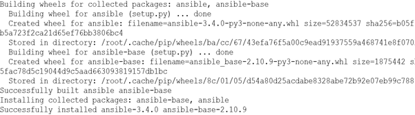

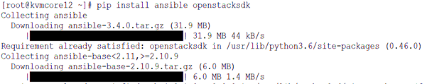

Step 3: Run the command: 'pip install ansible openstacksdk' to install Ansible and openstacksdk. You will see 'Successfully installed' in the output, or you need check your system settings.

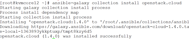

Step 4: Run the command: 'ansible-galaxy collection install openstack.cloud' to install openstack.cloud ansible collection. You should see 'openstack.cloud <version> was installed successfully', or you need check your system settings.

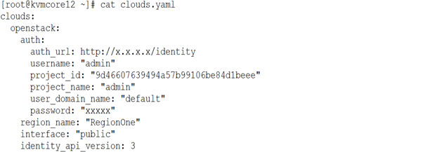

Step 5: Define a 'clouds.yaml', for the detailed definition of the file refer to https://docs.openstack.org/openstacksdk/latest/user/config/configuration.html#config-files
You need to modify the value according to your cloud settings:
Explanations on key configuration items:
 auth_url
The auth url that OpenStack keystone service is running on
 project_id
The ID of the project that you are operating against.
 cacert
The cert file that you needed to communicate with Cloud Infrastructure Center, you can find the file at ‘/etc/pki/tls/certs/icic.crt’ at Cloud Infrastructure Center management node by default.

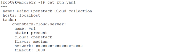

Step 6: Define a run.yaml (the name is just an example)
In this step a virtual machine is created, for the detailed description on each item or other functionalities, refer to https://github.com/openstack/ansible-collections-openstack
 name
The name of the virtual machine to be deployed
Create a virtual machine with given image ID
 timeout
Wait seconds before the action timeout, in Cloud Infrastructure Center, we recommend set this value to bigger than 1800 especially when IBM z/VM® is used.

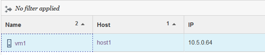

Step 7: All preparations are done. We can start to execute the Ansible ‘ansible-playbook run.yaml’, and finally the virtual machine will be created successfully.
