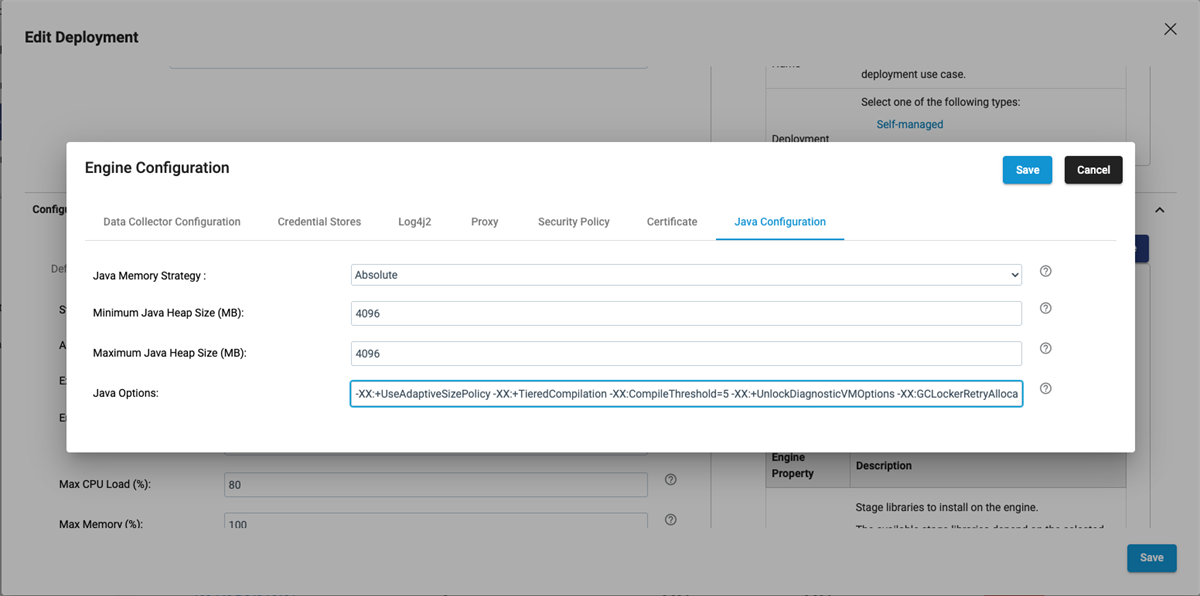

    Since the release of Java 17, we often recommend setting the Java Memory Strategy to Absolute, specifying actual Min/Max heap sizes, and these specific Java Options:
    -XX:+UseAdaptiveSizePolicy -XX:+TieredCompilation -XX:CompileThreshold=5 -XX:+UnlockDiagnosticVMOptions -XX:GCLockerRetryAllocationCount=100 -XX:MaxHeapFreeRatio=30 -XX:MinHeapFreeRatio=10
    Set the memory strategy to absolute, actual min/max memory for Java, add Java Options
