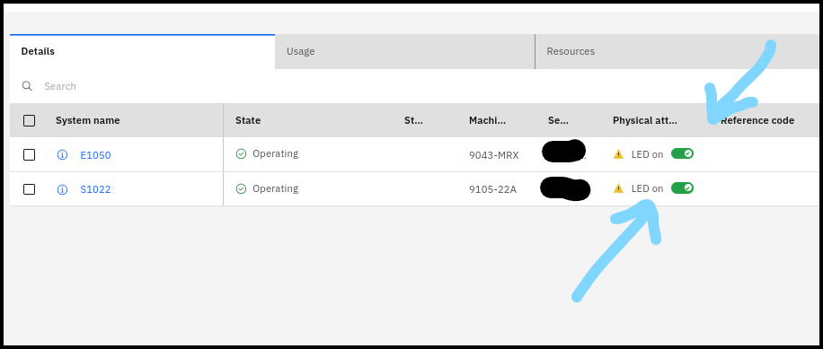

    Posted Mon January 13, 2025 08:06 AM
    This is easy to do from the HMC GUI ( see below )  - or I grabbed this about doing it from CLI as well ( so it can be automated  )
    The system attention LED can be disabled using the graphic user interface (GUI) service utility application, but it can be just as quickly done using the chled command. The managed system name is needed to run the chled command and the lssyscfg command can be used to retrieve all the managed systems names if you don't already know them.
    lssyscfg -r sys -F name
    Once you know the managed system name to use in the command line interface (CLI), check to see if the attention LED is active
    lsled -r sa -t phys -m <managed_system>
    Should see output similar to, "state=on."
    Use the chled command to turn off the system attention LED
    chled -r sa -t phys -m <managed_system> -o off
    To check the status of system attention LED you can use the lsled
    Should see output, "state=off."
    For more information on using the chled or lsled commands use the man page command on the HMC.
    man chled
    man lsled
