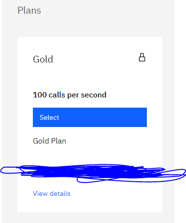

    maybe I was not clear during my initial question. I will try my best
    so In product YAML file , i have below plan. Please see the title or the description
    plans:
      Gold:
        title: Gold
        description: Gold Plan
        approval: true
        rate-limit:
          value: 100/hour
          hard-limit: false

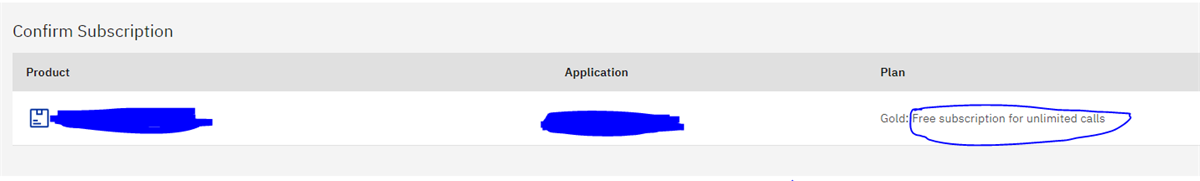

    when this is Published and consumer is trying to subscribe to the plan. this is what they see below. 1st pc is good as per the YAML and when they move forward after selecting
    see below , not sure from where this text is coming "Free subscription for unlimited calls" because this is not present on YAML.
    So I am trying to get rid of this text because this is misleading to consumer.
    Syed Imtiyaz Alam
  • 4.  RE: Plan description during subscription
    Posted Wed September 04, 2024 01:24 AM
    That's in the developer portal and it means free because some plans are monetised.
    you would need to look at customising the portal with a custom theme that overrides that twig template or similar - as a warning this might not be simple! It could be a lot of work to go to just to change one string.
    Chris Dudley
  • 5.  RE: Plan description during subscription
    Posted Fri September 06, 2024 05:00 PM
    So are you suggesting that whatever the plan we setup under the product, that string will always be there. I tried checking the drupal code where this string and was not able find it.
    Syed Imtiyaz Alam
