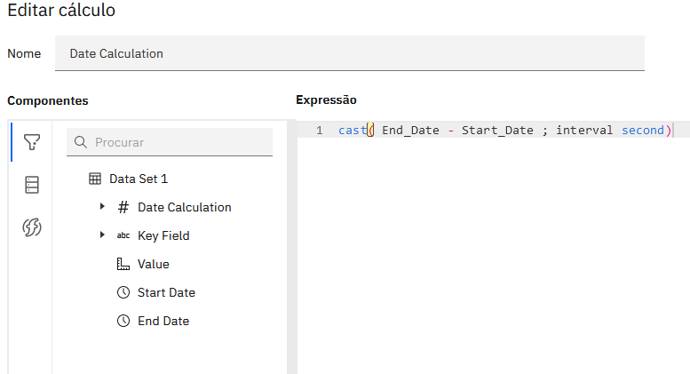

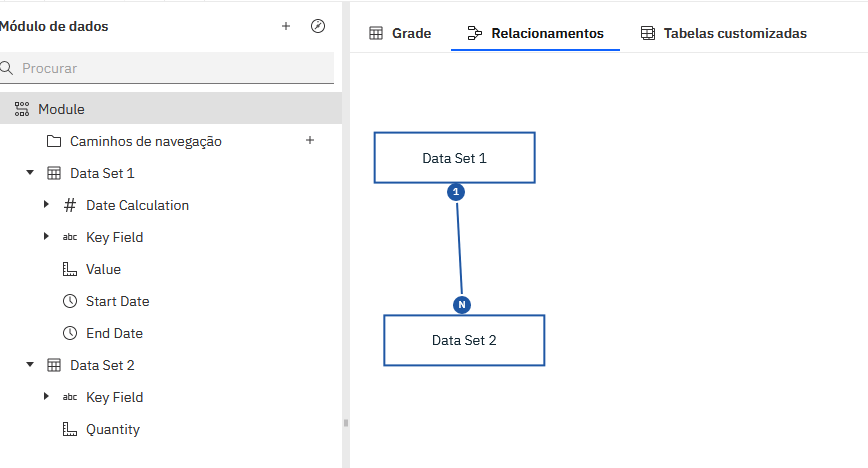

    So, this specific issue with time fields in datasets is simple to reproduce. Look:
    - There are two simple datasets that are joined by Key field.
    - Dataset 1 has two time fields: Start and End date
    - Date Calculation field is: cast( End_Date - Start_Date ; interval second). But same issue occur with _unix_timestamp ( End_Date ) . I need difference between these two timestamps in seconds.

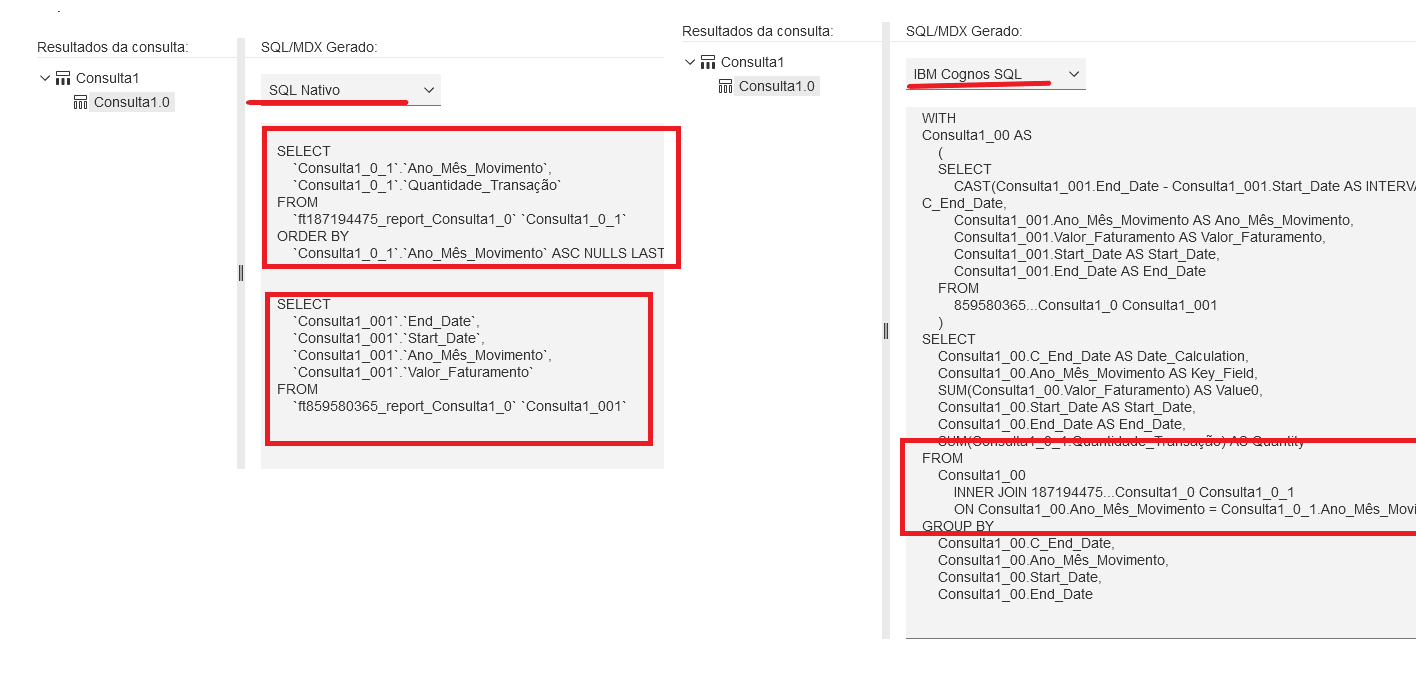

    When adding all those fields to a report, you will see that query is split and join is done by Query Service, not Compute Service.

  • 6.  RE: Block Local Query Processing
    Posted Fri October 07, 2022 07:10 PM
    The interval type is not supported with data sets.
    Use _seconds_between ( ) expression instead of type casting to an interval type
    https://www.ibm.com/docs/en/cognos-analytics/11.1.0?topic=administration-queries-uploaded-files-data-sets

    Thanks for your help. Function _seconds_between(  ) works when the two fields are from dataset.
    But, if I try _seconds_between( current_timestamp ; Start_Date ), local processing is done.
    The data module made by an user is doing exactly this, using current_timestamp.
    Is there a way to avoid local processing calculating with current_timestamp?

  • 8.  RE: Block Local Query Processing
    Posted Mon October 10, 2022 03:56 AM
    Hi Jeam, Did you try to use localtimstamp instead of current_timestamp? In some situation this prevents from local processing for reasons unknown to me. Also switching between table associated calculations and data module associated calculations or vice versa, even if it's against the bets. Also switching between calculate before or after aggregation sometimes makes this difference, also sometimes against my intuition.

    Posted Mon October 10, 2022 10:40 AM
    Hi Philipp,
    Using localtimestamp works without local processing. But this function does not consider my timezone, setting to GMT 00. I'm at GMT -03.
    If I try using another function to set timezone, local processing is used.
    But query macro has worked for me. I have tried _seconds_between( # timestampMask ( $current_timestamp ; 'yyyy-mm-dd hh:mm:ss' ) # ; Start_Date ) and all query was sent to flint service.
