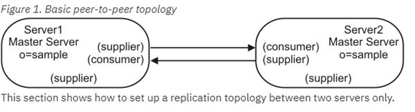

    Hi IBM SDS team,
    At present one of our client has master-master 2 ISDS servers with peer-to-peer replication topology.
    My client is looking for upgrading these 2 regions results in 4 ISDS servers.
    The aim is to setup replication between them.
     a) What is the Best approach to replicate 4 Master ISDS  in 2 regions?
     b) Is there need to set up replication queues across all 4 ISDS as per below configuration?
    https://www.ibm.com/support/knowledgecenter/SS3Q78_8.0.0/com.ibm.IBMDS.doc_8.0.0/ds_ag_srv_adm_repl_peer_topology.html
     c) Can below solution works or has any known issues?
    2 regions 4 ISDS servers replication topology - does this work?
    Thanks

    a) Depends on the ldap client application's needs: 1. If the client application(s) need data consistency and immediate data availability its better to go for 4 way peer (or master) topology. In this case updates made onto any master will reach any consumer in 1 hop. 2. If network bandwidth savings is the goal then the choice would be to use 1 master and 1 gateway per site, the gateway servers on both sites will replicate to each others. In this case the updates made directly to any gateway may take 1 hop to reach its peer gate way and onsite master, and 2 hops to the other site's master. In addition updates made directly to a master will take 1 hop to reach its onsite gateway, 2 hops to reach other site's gateway and 3 hops to reach other site's master.
    b) If you consider case 1 of having all masters then you'll need to set up 3 replication agreements (each agreement represents a replication queue) from each master going to other 3 masters. If you consider case 2, then you'll have 2 replication agreements on each gateway server going to its onsite master and other site's gateway, and 1 replication agreement going from a master to its onsite gateway.
    c) According to the picture presented, you need to configure the servers replicating across sites as gateway servers. Gateway configuration is a well supported configuration. The advantage is network bandwidth savings. Disadvantages include it may take more hops which may affect critical applications that may look for data consistency across sites and downtime on any gateway affects cross site replication.
    Now a days, the network bandwidth is cheaper, so most of our customers prefer to use multi master setup as explained in case 1.
