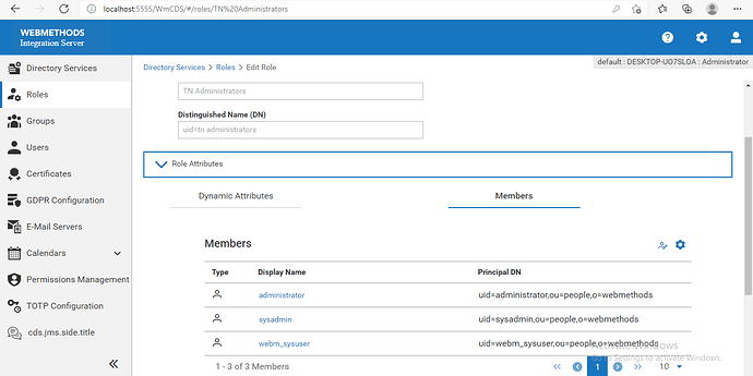

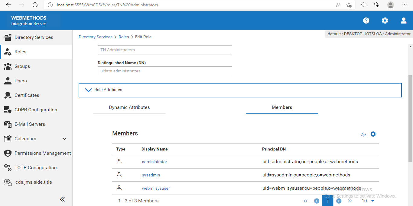

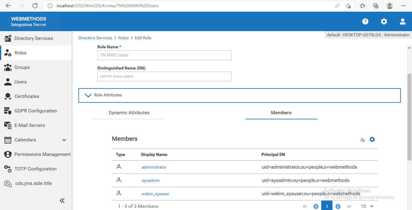

    Hi Experts,
    I have installed 10.11 trail version recently, I am able to login to IS with Administrator/manage credentials but not to MWS. I have also added Administrator user to TN Administrators and TN MWS Users Roles. Please find the screenshot for the same.
    Any help would be greatly appreciated.

    Hi Praveen,
    the roles in question are here “My webMethods Administrators” and “Admin Role”.
    sysadmin user is a member of Admin Role and the MWS Administrator User is a member of My webMethods Adminisitrators.
    TN roles are not involved here.
    Remember that the user Administrator in IS and MWS are different users, both locally to each server instance.
    Users from MWS storage can be members of ACLs in IS, but users from IS cannot be part of groups or roles in MWS.
    Regards,
    Holger
