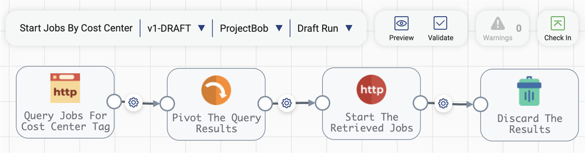

    The first Stage queries for Project Level Jobs tagged (example for a specific cost center), we Pivot the query results, then Start the Jobs.

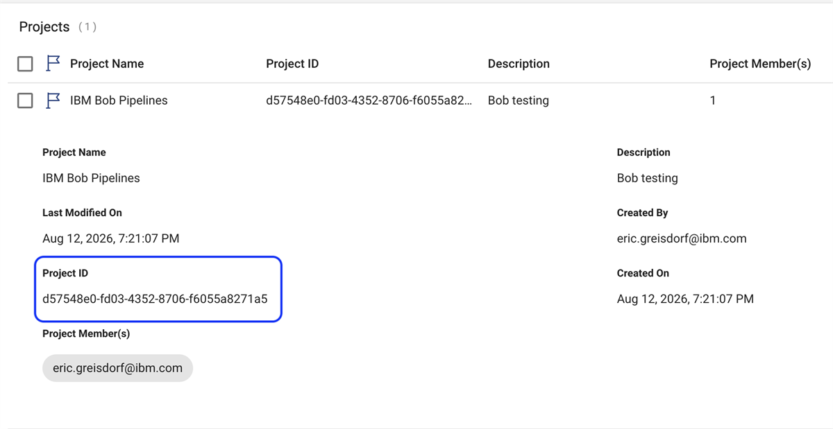

    The Project ID can be found under Manage Projects.

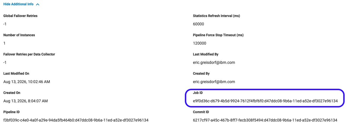

    The Job ID can be found under 'Show Additional Info" for the Job.
    Example Pipeline Job Being Started:
