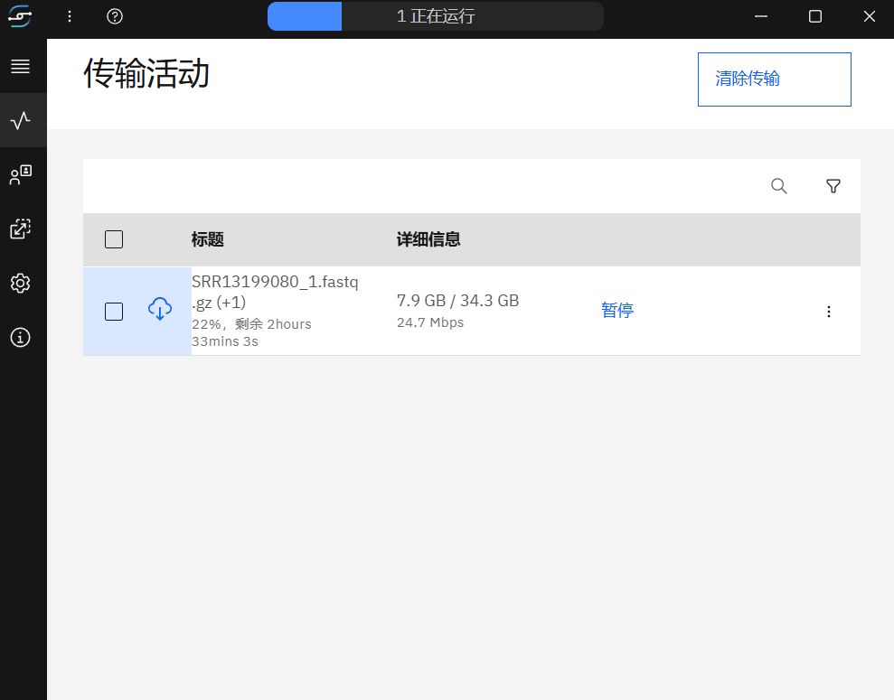

    With the help of some wonderful folks here on the forum, I recently managed to get both Aspera Connect and Aspera for Desktop up and running for downloading data from EBI. However, I've now run into a frustrating bottleneck - download speeds.

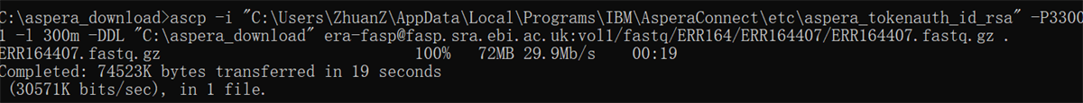

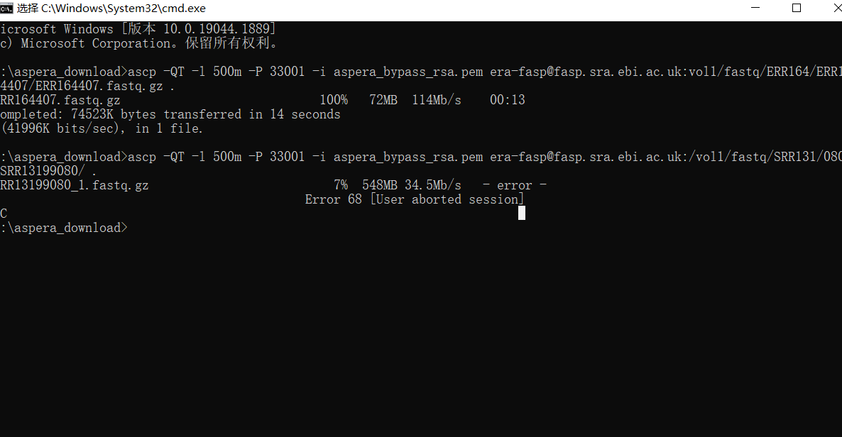

    When transferring files in the range of tens of gigabytes, I'm only seeing speeds of around 20–40 Mb/s, which honestly feels underwhelming for a tool that's specifically designed for high-speed transfers. For reference, here's the ascp command I'm currently using with Aspera Connect:
    ascp -QT -l 500m -P 33001 -i aspera_bypass_rsa.pem era-fasp@fasp.sra.ebi.ac.uk:/vol1/fastq/SRR131/080/SRR13199080/ .

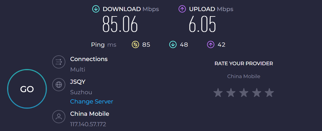

    I checked the logs file (see below) and ran a bandwidth test on my end (see attached image).
    Does this mean I need to upgrade my internet connection to get faster download speeds?

    Nothing can transfer bytes faster than IP-level speed.
    In your case, in case of download, it's 85Mbps.
    If you had a local internet connection like the following (ethernet and optical fibre), you would surely achieve better results.
