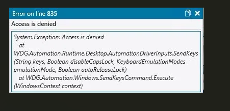

    1. Regarding Send Keys Issue:
      IBM RPA is running on the Jump Server itself, and Send Keys
      is targeting an application on the same Jump Server.
      The issue occurs when the RDP session to the Jump Server
      becomes inactive or locked.
      Please see Screenshot 1 for the exact error.
    2. Screenshot showing IBM RPA Studio error dialog on line 835.  The error message reads:

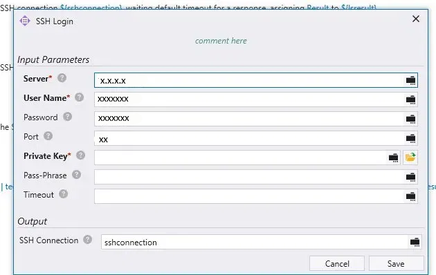

    2. Regarding terminalSshConnect vs executeSSH:
    - SSH Login command works successfully and returns
      a valid SSH connection object.

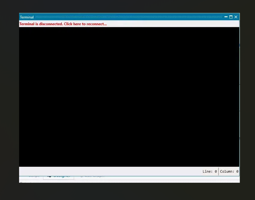

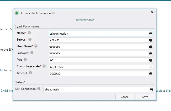

    - Connect to Terminal via SSH always shows
      "Terminal is disconnected" immediately,
      even with correct credentials (Server, Username,
      Password, Port ).
    • Please see Screenshot 2 for the Terminal window
        and Screenshots 3 & 4 for both command configurations.
    • Screenshot showing IBM RPA Studio Terminal window (Designer view)  with a red message at the top:
    • Screenshot showing IBM RPA Studio SSH Login command configuration.  Input Parameters: Server (hidden), Username (hidden), Password (hidden),  Port (hidden), Private Key empty, Pass-Phrase empty, Timeout empty.  Output: SSH Connection variable named Screenshot showing IBM RPA Studio
    The difference is:
    - terminalSshConnect → Opens Terminal Window inside
      IBM RPA Studio → Always disconnected ❌
    - executeSSH → Sends commands directly via SSH
      without Terminal Window → Works successfully ✅
    3. Regarding the Terminal is disconnected message:
    This message appears inside the IBM RPA Terminal
    window in the Designer view, not in the script logs.
    IBM RPA Version: 30.0.2
    Thank you for your support.

  • 4.  RE: Send Keys returns "Access is Denied" when RDP Session is inactive - IBM RPA
    Posted 07/17/26 02:17 PM
    That's strange.
    How did the Windows session go idle if the automation is running?
    As long as something is happening on the computer, Windows won't lock the session.
    But anyway, if the session is locked, IBM RPA really won't work, because any action that IBM RPA sends to Windows won't be processed, since the session is locked.
    As for the terminal, I understand now.
    Try using a different value for the --cursorkeysstate parameter. If that doesn't work, then it might be a bug.
    I don't know why there are two commands for accessing SSH server, but I've noticed that they use different components.
    Perhaps one of them is designed for a specific type of SSH terminal.

    1. Regarding the session lock:
    To clarify the Send Keys issue further - the script actually
    works fine when running from the Control Room (Unattended mode).
    The problem only happens in this specific scenario:
    - I connect to the RPA machine via Remote Desktop (RDP)
    - I run the script manually from IBM RPA Studio
    - The RDP session disconnects or goes idle during execution
    - At that point, Send Keys fails with "Access is denied"
    The reason the session goes idle is that the script was
    waiting for a long-running SSH process to complete
    (could take 1-2 hours). During this wait, there is no
    UI interaction happening, so Windows locks the RDP session.
    So the root cause is that Send Keys loses its Windows context
    once the RDP session is disconnected or locked.
    2. Regarding terminalSshConnect:
    I have already tried both "Normal" and "Application" values
    for --cursorkeysstate but the result is the same
    "Terminal is disconnected" in both cases.

  • 6.  RE: Send Keys returns "Access is Denied" when RDP Session is inactive - IBM RPA
    Posted 07/17/26 04:02 PM
    1. SendKeys
    This is completely normal and expected behavior.
    What you can do is configure your VM not to lock the Windows session or increase the time before it locks.
    From an IBM RPA perspective, there's the preventSleep command, which runs in the background and constantly moves the mouse pointer to try to "bypass" Windows' idle control. It's not 100% guaranteed to work, but it's worth a try.
    In my opinion, the best approach is still to change the Windows policies to disable session lock or increase the time before the session locks.

  • 8.  RE: Send Keys returns "Access is Denied" when RDP Session is inactive - IBM RPA
    Posted 07/30/26 09:03 AM
    I don't know if Sofia has spoken with you, but we have an issue in version 30.0.2 that affects the terminalSshConnect command.
    Updating to version 30.0.3 might resolve this issue.
