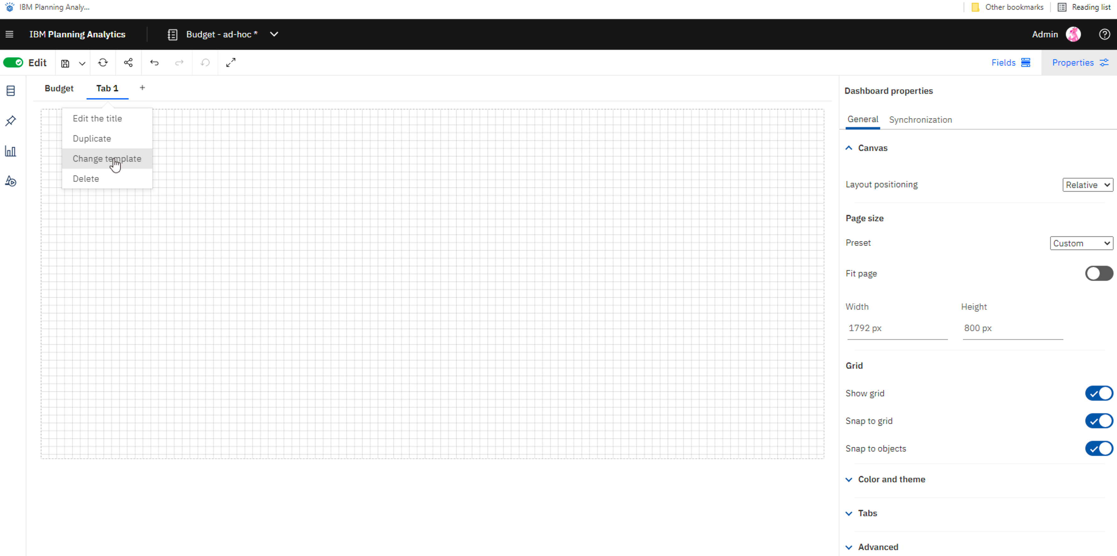

    I assume you are using one of the templates that resize otherwise you can change the template for the individual tabs.
    I also have to play around the various layout and positioning settings to get things exactly as I want them. I often use the relative positioning and turn off the 'snap to object' which allows for an independent placement of objects when I don't need the objects to align.
