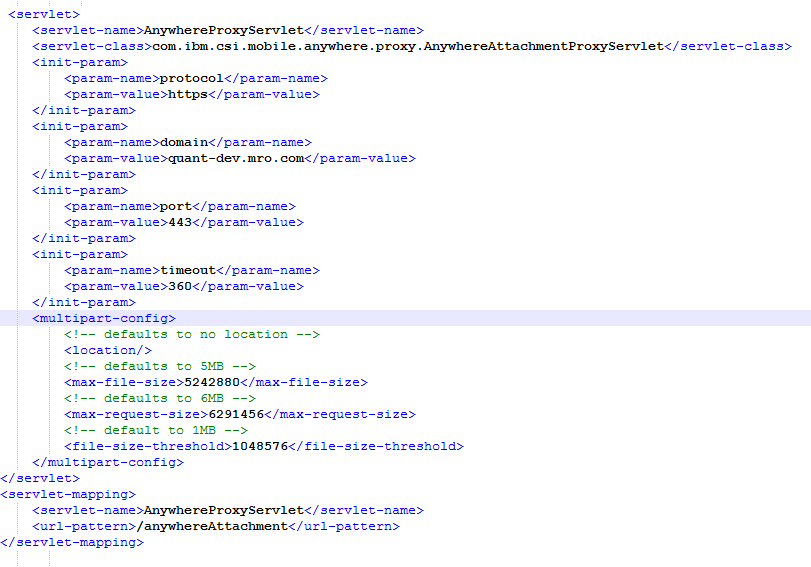

    You receive a 404 error when uploading or downloading an attachment
    1. I have checked this technote and web.xml in the MaximoAnywhere.war has the attachment servlet.
    2. One difference I have observed is that, the web.xml in the MaximoAnywhere-2.4.war has the attachment servlet but the below xml section is missing.
    <multipart-config>
    <!-- defaults to no location -->
    <location/>
    <!-- defaults to 5MB -->
    <max-file-size>5242880</max-file-size>
    <!-- defaults to 6MB -->
    <max-request-size>6291456</max-request-size>
    <!-- default to 1MB -->
    <file-size-threshold>1048576</file-size-threshold>
    </multipart-config>
    3. Also, running the URL http://<hostname>:<port>/MaximoAnywhere/anywhereAttachment
    returns the response
    Error 404: javax.servlet.ServletException: java.io.FileNotFoundException: SRVE0190E: File not found: /anywhereAttachment
    4. I have also confirmed the timestamps in the worklight console, they check out pretty good.
    5. Mobilefirst version is 7.1.0.00-20190329-1256
    6. WorkExecution App build is successful. And the app is built for Android 28 API. (https://www.ibm.com/support/pages/building-maximo-anywhere-applications-android-28-api)
    Please suggest what could be done to resolve this. Thanks!

    Hi Samvid,
    I would make sure that your Websphere plugin-cfg.xml also contains the context root of anywhereAttachment
    If not then you would need to generate and propagate the webserver plugin
    Thanks
    Chris

    Samvid,  errr. just a sanity check here.... You are running WebSphere 7.x? The MaximoAnywhere-2.4 is for WAS 7.x only.  I f you are running WAS 8 or higher then the you need to use the MaximoAnywhere.war. Also you MF version seems out of synch.  What does the rest of your product stack look like?

    Hi Bradley,
    Thanks for your reply. Yes, we are running WebSphere 8.x.
    As you suggested for WAS 8.x, I checked the web.xml inside MaximoAnywhere.war. It has the necessary attachment servlet.
    Also your MF version seems out of synch - May I know why do you say this?
    System info from maximo and worklight console is copied below for your reference.

    Hi Samvid,
    Is attached doc working for Maximo?
    https://www.ibm.com/support/pages/setting-attached-documents
    Do you have "mxe.oslc.restwebappurl" system property configured with a hostname (with domain name), port number?
    For example:
    http://host_with_domain_name:port/maxrest/oslc/
    Technotes:
    https://www.ibm.com/support/pages/cannot-upload-attachment-anywhere-application-maximo-desktop
    https://www.ibm.com/support/pages/404-error-when-uploading-attachments-maximo-anywhere

    Thanks for your reply. The attachments were working before I built the AW apps for Android28 API. Let me cross-check the configuration in my Maximo environment with the links shared by you.
