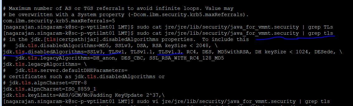

  • 18.  RE: ILMT Hardware Inventory status showing error (ILMT Agent disconnected scanner)
    Posted Thu September 19, 2024 05:04 AM
    Hi Nagarajan
    You re-opened case TS017166253 which you have opened since also starting this ILMT forum thread for the same issue.
    Please follow latest steps provided by Oktawian and provide the vmman.out log to case TS017166253 for our review.
    Thanks, Cassia
    CASSIA MATTEO
  • 19.  RE: ILMT Hardware Inventory status showing error (ILMT Agent disconnected scanner)
    Posted Fri September 20, 2024 12:57 PM
    Hi Oktawian,
    I have attached the screen shot of trace.log_vmmconf_xxx.log and full log file I will upload into TS017166253.
    Thanks,
    Nagaraj.
    Nagarajan Singaram
  • 20.  RE: ILMT Hardware Inventory status showing error (ILMT Agent disconnected scanner)
    Posted Sat September 21, 2024 02:45 AM
    Hello Nagarajan,
    Indeed, it's just 'Remote host terminated the handshake'...
    No root cause (I still opt for TLS version mismatch),
    As the next step, I'd have to add this VMM_PROPERTIES_DEFS property vmman.sh script...
    Thank you,
    Oktawian
    Oktawian Powązka, L3 Support
    IBM License Metric Tool
  • 21.  RE: ILMT Hardware Inventory status showing error (ILMT Agent disconnected scanner)
    Posted Sun September 22, 2024 02:19 AM
    Edited by Nagarajan Singaram Sun September 22, 2024 02:19 AM
    Hi Oktawian,
    I need to add the following line into vmman.sh file in screen shot marked right?
    VMM_PROPERTIES_DEFS=-Djavax.net.debug=all -Dcom.sun.xml.internal.ws.transport.http.client.HttpTransportPipe.dump=true
    or
    VMM_PROPERTIES_DEFS="${VMM_PROPERTIES_DEFS} -Dcom.sun.xml.internal.ws.transport.http.client.HttpTransportPipe.dump=true -Dhttps.protocols=TLSv1.2,TLSv1.1,TLSv1 -Dcom.ibm.jsse2.disableSSLv3=false -Dcom.ibm.tools.attach.enable=no"
    The marked line continually or next line I could add the property value right?
    Once added the value then I have to execute the following cmd right?
    vmman.sh -testconnection > vmman.out 2>&1
    and share the output file of "vmman.out 2>&1.
    Thanks,
    Nagarajan.
    Nagarajan Singaram
  • 22.  RE: ILMT Hardware Inventory status showing error (ILMT Agent disconnected scanner)
    Posted Sun September 22, 2024 09:37 AM
    At the end of existing line add continually :

    I have added the TLSv1.3 value as per below screen shot and we tested the vmman.sh test process. but it was not helped.
    Correct me If I add the vale in the right direction to disabled TLSv1.3 in ILMT.
    Because Our network team if enabled TLSv1.3 from firewall then our testing is completed, if they disabled TLSv1.3 from firewall then our test would failed with SSL error.
    Also our network policy should be disabled TLSv1.3 in infra.
    Thanks,
    Nagarajan.

  • 39.  RE: ILMT Hardware Inventory status showing error (ILMT Agent disconnected scanner)
    Posted Sun October 13, 2024 03:38 AM
    Hi,
    I'm not sure which screenshot are you referring to...
    Anyhow, disabling TLSv1.3 protocol been described in update nr. 24
    There is no other way.
    An uploaded output (vmman_test.out from 2024-09-26) confirms that TLSv1.3 has been disabled.
    TLS handshake is started with TLSv1.2 only
    Thank you,

  • 40.  RE: ILMT Hardware Inventory status showing error (ILMT Agent disconnected scanner)
    Posted Mon October 14, 2024 07:56 AM
    Edited by Nagarajan Singaram Mon October 14, 2024 07:58 AM
    Hi Oktawian,
    Sorry my last post I may missed the screen shot of TLSv1.3 disabled in java_for_vmmt.security file.
    Thanks,
    Nagaraj.

  • 41.  RE: ILMT Hardware Inventory status showing error (ILMT Agent disconnected scanner)
    Posted Tue October 15, 2024 03:54 AM
    It's all correct...
